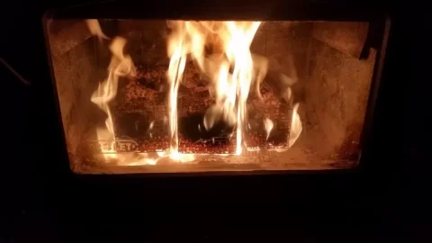

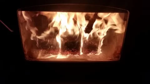

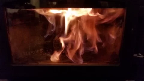

Saw an old thread on this from member mass burner and it sparked my interest. I purchased a set of 3 pellet logs and have been doing some testing. I am not a heavy wood burner and really only use the stove when I get home from work in the evening for a few hours and on the weekends. So these have been working good for me when its mild and I don't need a ton of heat.
3 of these logs hold about 10 lbs of pellets. I fill 3 up and place a firestarter under them towards the front of the stove. They take off really quick and it doesn't take long to get good secondary combustion. Usually get around 500-600 for a good hour with the air all the way in. You do need to be careful as with too much air these things will burn extremely hot.
To refill I just shovel new pellets into the basket and the embers on the bottom get then fired back up in no time.
Cost about $1.30 a load.
