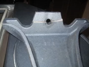

I didn't see the single connecting bolt as the primary issue. It was its location in a cast iron item and the configuration of the item that seemed to be working against it. I'll try to get some photos to illustrate.

Okay, maybe THIS will work. Here are photos of the leg that broke.
Well, I'll be darned. It DID work! I'm more surprised than anyone!

OK. I am on the same page of the hymnal with ya now cuz. That is mighty thin cast for a stove leg.
Seems to me the whole top mounting plane just isn't substantial enough for what it's being asked to do. Especially for cast. And you can see, it broke right in line with the outside corner pieces. Maybe I'm missing something, but it looks like that whole piece should be solid with only access holes.
With the position of that hole in that tab they are gonna have a bunch of busted legs happen at install time.

Sure looks like a good possibility or maybe during shipment, like this 'un!

After more cogitation, I'm planning to put in a larger washer under the bolt head to spread the strain of the bolt over a larger area. As it is there is a lock washer which is the same size as the bolt head, which, IMO, increases the lateral force into the hole predisposing it to break. I've got some heavy half-dollar size (or maybe a little larger) washers which should eliminate that. I'll replace 'em all because however much the location might heat up will increase the stress. Thoughts/Reactions? Am I missing something that will cause that to be a problem?
Forget the washer. Make a rectangular piece of steel to spread it out over the whole flat surface of the leg.

Do you mean put the steel in the same place I'd put the washer? Hummm! I thought the bolt might be too short for that application, but maybe not or maybe I could find a longer bolt. I was also cocerned about the differential heating of the steel right against the cast, but maybe that isn't a problem. I also thought the washer might conform to the contours of the underside of the leg/bolt tab and be more effective, but maybe not. Also concerned about too much torque into cast threading on the frame, but it may not be anchored into cast--it's pretty hard to see with it upright and I'm not planning to put that thing on its side! Kinda feel like I need to do something, just not sure what.
Easy on the washer stuff. That casting is not a machine finish - meaning that you can inadvertently create a pressure point while trying to spread the load. Stick with the original bolt, but make darn sure that there is no side pressure put on those legs - EVER.
Vertically - that one leg could hold up your pickup truck (assuming here ;-) ). Horizontally, it could snap pretty easy. The casting looks to be of a very high quality (you can tell by the grain of the cast), but it also appears to be a bit thin, as BroB pointed out.
If you DO decide to use a washer - don't go extra thick, rigid type. Go with a standard thickness of washer that may allow a little bending if need be.
