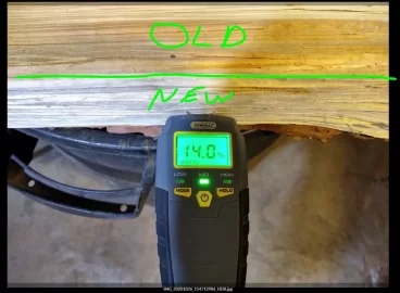

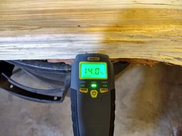

Currently burning some 5+ year old pine early this fall. Took a split and re-split it and then poked it just out of curiosity.

JRHAWK9, this pine was previous not split I'm guessing?
it was previously split...and stacked for 5+ years under a top cover.
You can see the difference in color between the original split face and newly split face.
[Hearth.com] The importance of seasoned wood - Dry vs Wet
Reactions: LiamFitzpatrick
Just wondering, maybe thats as dry as pine will get. I've been liking burning pine for a few years now and after a year covered its at 14 or less for me.
You probably have much better drying environment than I do. My wood is stacked in the middle of the woods, so it doesn't get much sun or wind during the summer months. Once the leaves are off the trees, then it gets some sun and more wind, but we don't get much sun in winter around here. Plus the temps in winter are not conducive to drying either. ;lol
Wood does lose/gain moisture once it reaches that equilibrium point though. So I'm guessing this pine has been at that point for quite awhile now and it's moisture has been dependent on how humid/dry the air has been. I was actually surprised at how low it was knowing how humid our summers are and the environment at which it was stacked in over the years.

Take a peek at the bottom of this page. Should explain why your low M/C point is where it's at. Looks very normal for your location.
yup.
I'm still waiting for my oak to get to that point though. Stuff I will be burning this winter, once I start burning oak, was split/stacked in fall of '14. So 5 years. Last time I checked a few splits it was right around that 18-19% area.
Our wood is in direct sun most of the time, that's likely the difference.
