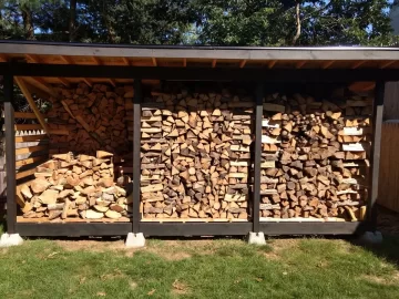

Show your wife some wood sheds from this site to show what's normal.
I (plan) to only burn 2.5-2.75 cords a year. This is my 3 year shed. (It's full now.) 8 ft deep, avg 7 ft tall, 18 ft wide.

Oh, shed porn. :)
Show my wife what's normal?
Uh oh.
Several years ago I asked the question "how many cyclocross bikes does someone really need?"
Turns out, for me, the answer was five. :)
Normal?
Normal isn't my issue. (It *is* a concern of my wife...) Real estate is the challenge. I just don't have good space to bank more than about five cords, and yes, I am planning on building a shed in the spring... :)
Hey at least I suggested*you* show things ....
