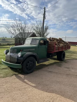

I filled the wood rack yesterday. The wood has been on this truck for three years...sitting in the machine shed. I'm pretty sure it's ready to burn.
