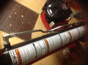

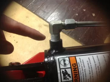

    I have a leak with the hydro oil but I don't know exactly how to go about tightening it up, any ideas....thanks all
    My finger is pointing to where the oil comes out...

    Disconnect the steel hydro line, then either tighten the fitting one turn, or better yet remove it and reseal the fitting withTeflon tape or what the manufacturer recommends. Reattach line, then check and refill hydro oil.

    Shut down and cycle splitter SCV, to be sure system is depressurized. Loosen and remove flare nut (on thinwall pipe). Remove elbow from cylinder, clean threads, re-tape (or dope) only the NPT end (not the flare fitting end) of elbow, reinstall in reverse order.

    Much better explanation than mine.

    Great thank you very much guys...

    Thanks for your help, Joful, but how do you cycle the SCV? And what is the SCV?

    Right now it is off and I'm sure full of oil

    Also it needs to make a full turn in order to reconnect

    Selective Control Valve.
    Jiggle the handle. ;lol

    You'll get some oil out, but if you work with the cylinder vertical, and something holding the ram up, you shouldn't lose too much. Messy, yes. Complete unloading, no.
    Yeah... one of the down-sides to using NPT elbows. It's made worse by the fact that you have steel on steel there, since neither the elbow or the bung on that cylinder are too forgiving. Give it three wraps of tape on the elbow, then install. Tightening an NPT fitting is a "by feel" kind of thing, in that you are not hunting for any particular torque, but you're hunting for the point where torque suddenly increases rapidly. Then you know you've taken up the slop in the taper, so to speak. Only thing that's critical here is that you can never go back. Tighten only. If you overshoot, and decide you need to loosen a half turn to get back into alignment with the flare nut, you better remove, clean, retape, etc.
