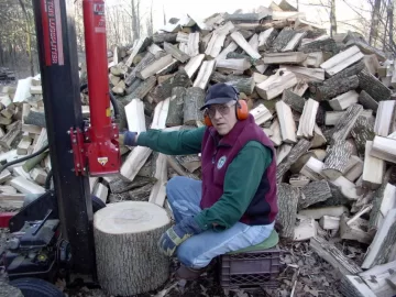

    How far from the splitter. See my avatar or look at this:
    Dennis Cook 4-4-09c.JPG One thing I'd like to comment on with this position. Many have brought up the fact that occasionally wood may split off and fly like a bird and they can cause damage. Not so with this position. For sure the ones that go flying are off of smaller rounds than this one and if they do go flying, they will always go sideways and never at the fellow who is doing the splitting. I've never been hurt working like this.

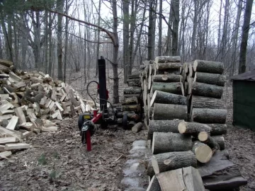

    How do I position the splitter?
    3-31-09b.JPG This should give an idea of how I do it. We do all the cutting during the cold of the winter and just loosely stack the wood where we want to split and stack in the spring. You can tell this picture was taken in the spring because of the ice right next to the log stack. But I just get the splitter as close to the stack as possible and can split a lot of wood before having to move it ahead a bit. I don't remember this picture why I had that short row in the back but usually I start back there and bring the splitter forward as needed. In these rows, I had to move the splitter 3 or 4 times per row. A very short task that takes about 2 minutes.
    Notice too that I have the logs on my left and the splits get thrown on the right. I've tried it the opposite but this way works best for me. One reason is that on the smaller logs and even when you get the big logs broken down, many times I can reach for the next log while the wedge is going through the log that is on the splitter. A time saver.

    Yes, I'm one who claims splitting is easy while sitting. My back simply will not take either the standing nor the bending to lift every log up to the height it needs to be for splitting horizontally. Now if you are just splitting a little bit and it is on a wagon, trailer or truck, horizontal can be good in that situation. I don't do it this way and just prefer to wait and do all the splitting at the end of the cutting season.
    I do not understand the comment about straining the back while sitting. On the contrary, it eases the back if it is done right. As for reaching for the handle, you have to put your hand on the handle no matter what way you choose to split. As you stated, the "only" strain when splitting horizontally is when picking up the splits. I do not pick up the splits and if I had to do that, I could not split. In addition, add it up over a day's time and figure how much weight you are lifting. That all takes energy; a lot of energy. Young studs might get a kick out of all the work they are doing but my theory is that I have the hydraulics to save me some work and I want to save as much as possible. Therefore, I will not lift each long up onto the splitter.
    Again, I do hope to show you when I get the video made. You may or may not agree and that is okay.
    It does not bother me if you question the "wisdom." Yes, I have split more than a few cord of wood and have tried many ways of doing it. If you have tried to sit and couldn't do it, my suggestion is that you were either sitting too high or not sitting squarely behind the log and perhaps not using the best method of moving the logs to the splitter.
    You may be comfortable standing and i know of others who are. Some even have too large of a pot gut to allow them to sit comfortably and that can indeed cause problems.
    I do not understand at all your comment about getting bopped real hard with the lever popping down on auto return. Either your splitter is a lot different than mine or, I suspect more likely you were sitting way too high and certainly not sitting behind the log like in my avatar. My head is no way near that lever so I do not understand how it could happen.
    What about reaching for that next round? Really easy to do here and as I've stated, most times I'm reaching for that next round while still splitting a log! When the rounds are really close it is extremely easy. If a reach is in order, a pickeroon comes in very handy (and for other things too; a very handy tool). Before I got a pickeroon, I many times simply used the axe to reach for some logs. When the reach becomes too far, that is the time to move the splitter ahead a bit, which is a nice little break.
    Joful, that is about the same way I do it except for those little mini-breaks to get up and move the splitter forward a bit. Then I usually take the time for a little drink too.
    Not sure why you can not get the splitter close enough. Never had that problem.
