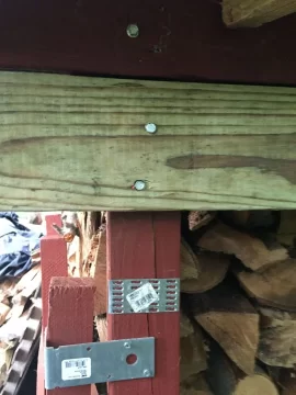

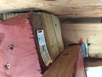

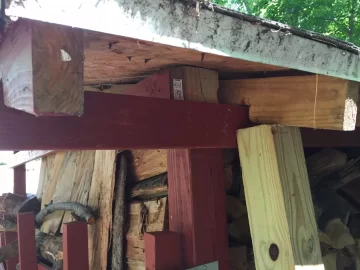

A big branch fell down on my woodshed and sheered the bolts holding the roof. Here are a few pics so you can laugh at my lack of proper shed construction. I always meant to get up there and put lag bolts and another 2x4 on the inside, but didn't want to remove the wood to do so. You can see were the screws let go by the lack of stain color. Luckily one of the three posts held.

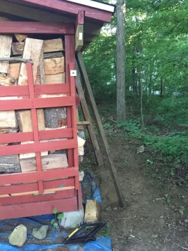

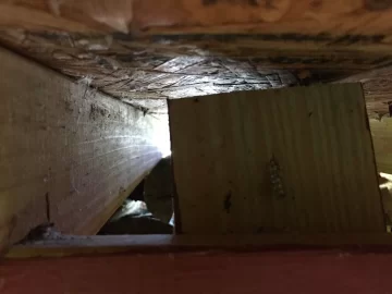

So I got the car jack out, jacked the roof back up and added a 2x6 with 2 lag bolts per post. Then I reinforced the old 2x4.
