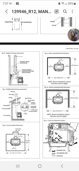

That's a little wet but I am sure the biggest problem is the chimney setup
I thought there was no possible way Jotul would suggest a "slammer" type install. However, I was mistaken.

could there be some sort of manufacturers defect with the air intake? or is there a way to test the chimney setup? it seems to be drafting fine. no smoke comes in the house
I seriously doubt it. The chimney is what drives your stove and your chimney is drastically oversized for your stove meaning it just won't work properly
SpaceBus
Nov 18, 2018
7,375
Downeast Maine
That is a direct connect not a slammer. Still not good but better than a slammer
It's not even direct connect. They say to stop the stovepipe at the same point as the tile liner starts with no coupling. I can't believe their lawyers let this go.
That's how they are all done. There is no way to make a real coupling

I guess you can't get up there to make a block off. It seems unsafe to do at all without a full length liner.
Oh it is a bad setup for sure. Not saying otherwise. Just not as bad as a slammer
That's not a slammer, it's a direct connect. If the blockoff plate fitting is sloppy then that will further dilute the draft.
Note the caveat with flue sizing for this stove.
The chimney flue size should not be less than the cross-sectional area of the stove flue collar, and not more than three times greater than the cross-sectional area of the flue collar.
the flue is rather small….maybe 10” in diameter. So, I don’t think it’s oversized.
begreen
Mooderator
Staff member
Nov 18, 2005
99,711
South Puget Sound, WA
With dry wood and a full-length, insulated, 6" stainless liner connected to the Jotul you will think you have a whole new stove.
