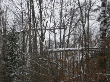

[Hearth.com] Twin widow makers and the neighbor wants them gone [Hearth.com] Twin widow makers and the neighbor wants them gone A neighbor wants me to cut these down from his wood lot. Ones Poplar and the other is a Sugar Maple. Has anyone cut something like this before? I haven't.... I would think if I notch and hinge them they migh want to go backwards instead of the way I'd like to fall them forward. I'll leave a good exit!

Cutting on the ground is not recommended for dropping widowmakers... can you get a bucket truck in there?
If you cut at the base, they'll likely fall to the side. If they fall. A crane or claw would serve to hold the broken tops in place while cutting.
Yep, I'd get a pro to tackle those things.
rope tired to another tree with pressure, then make cut, tighten rope, make another cut, tighten rope, then pull down with quad.

I do not try to cut them down! If I can pull them down with the tractor or a comealong fine if not then they stay till they come down on their own. Had a big red oak behind the house that would not come down so left it and it came down on it's own a few weeks ago in a rain/ wind storm. BE SAFE.
personally, i'd just wade in there and cut them like any other tree, just very slowly and ready to move quick at the first sign of movement.

That's what I was thinking but it'd be good to know which way they'll come down. I like a good mystery except when it's tons of wood coming down near me! Lol

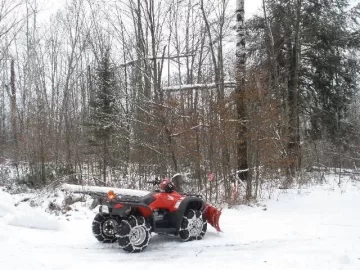

Edit, I have 50' of winch rope on the ATV and a few hundred feet of chains and straps. I'm thinking I'll make a cut on the side opposite of where I took the picture and pull each one down with the ATV, being a safe distance from the falling trees. The higher I can get the connection up the tree the better. I'll take a better look at it in the spring when I start cutting my rounds again.

Use a throw line to set a pull rope around the broken tops, and pull them down from a safe distance with a winch, truck or whatever. If you don't have the equipment or experience to do that then you're in over your head. I hate to be blunt but it would be worse to see someone get hurt.

I'd see if I could get a rope/chain/strap over the tops and pull them down until the weight is on the ground.

A coat on a tight rope or chain keeps it from being a guided missle if it breaks. Learned that here AFTER a close call.

Here is a procedure to consider. Keep in mind that I am not an expert at anything, however I have survived 60 or so years doing all kinds of risky things that others would not get near. My largest felling was done with a sledge hammer, an 80' cinder block silo.
A helper or spotter would be of great value. First step would be to get a rope, cable, strap or whatever as high on the standing trunk as possible. Secured to the pulling device in the opposite direction that the tops have fallen. Pull it to almost snug (too much and it will want to cause the drop prematurely). Next, cut your notch on the pull side (opposite of the way the top fell). Get your opposite cut and leave a firm hinge. Attempt your pull, if too much hinge remains, back off to almost snug and take a wee bit out of the hinge, retry pull.
If this was my chore, I would go at it just as described.

Also for pulling them down with truck or large tractor and long HD rope/chain. Surely wouldn't do it for free unless they were mine.
I would make my cuts 90 degrees on on side or the other from the side they are broken on and use a rope to bring them down. Had one across my driveway that looked identical
I would wait for nature to take its course. I am sure there are other trees waiting to be processed.

I would agree very much with this. A tree on the ground is one thing, but there's a reason people call the professionals to remove trees like this. Could you do it? Maybe. Could you die? It's possible.
I know that a foot long semi seasoned round of poplar weighs a few pounds....30 of them together would really wreck your day if it fell on you.

I would throw a weighted rope over it in a good spot and try to pull them down. I wouldn't cut them as my reflexes are not as fast as the branch falling on me. those things could let loose fast. It is a better job for pros.
I have pulled a bunch of trees down using steel cable that I bought made for winches. I use the 5000 pound cable with loops formed on the ends. I have enough for 300 feet.
