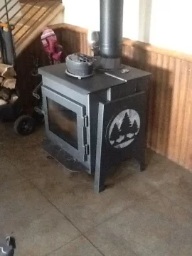

After sitting in the garage all summer the IS got installed day before yesterday, burned the shipping crate for 2 smallish break-in fires, first significant storm cycle hits tomorrow afternoon, lows in the teens day after tomorrow .... anxious to stretch the legs and see what this fancy new fangled wood-burner can do!

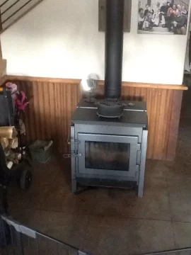

Side notes of interest: 30-NC got installed in my buddy's drafty and poorly insulated train depot remodel-in-constant- progress replacing a high school shop class built smoke dragon, his keg-erator was emptied, top down fires were discussed at length and the mini who just turned 1 now says "hot" and points at the IS. All is good! Extensive real world comparative Ideal Steel vs 30-NC reviews to follow.
I think many people will be interested to hear the results. Many of us have found that running the stove in the 3-5 notch range gives the best burn times. On a cold start, get the stove good and hot before engaging the cat.
Can we get some pics with the reviews - show us a fully loaded stove!
It is going to be a boring winter. Open the draft, wait 30 seconds, stir the coals, load the stove, let it flame up, turn to 1/4 air, engage cat, repeat every 12ish hours. It will cruise at 350-400 for the duration, the house stays at 72 and the heat never kicks on. What am I going to do with all my spare time?

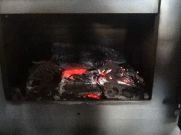

I've only loaded it partially full of spruce and fir a couple times and am getting 10+ hours of heat and matchless relights after 12+ hours. Color me impressed with the stove so far. I have 2 cords of oak that will be reserved for the dead of winter when I need more BTUs per load.
Lows in the high 20's last night, high today of 38. I filled it just less than 1/2 full at 7:30 last night and had it damped down and cruising at 400 before 8:00. Got up this morning at 7:00 to a small bed of coals a 70 house and a 300 stove top temp. Stirred the coals, threw on a handful of small diameter scraps underneath 5 good size splits (1/3 full), made coffee and breakfast, turned the stove down to 1/4 air and engaged the cat. It's now 3:00, stove is at 350, house is at 74, outside is 38, and I have hours left before it needs any attention. (see photo) Once the cat is engaged, there is very little evidence that there is even a fire burning.
I ended up with a soapstone lined firebox, side panels and an ash pan delivered to SW Colorado for around $2400. More to come once real winter hits.

Congrats on a successful setup. Many people think this hybrid won't burn full cat, but I see it all the time. It gives awesome burn times without the flames. Did you adjust the air at all in the burn or let it cruise?
Think about all the wood you will save :).
