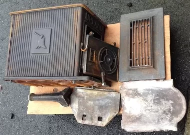

One of our kind members allowed me to buy an old Upland 17 which was in a home that he moved into. We picked it up in the Philly area on the way to DC.

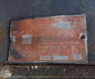

I'm going to restore it as time allows. It looks to be in fine shape. As per the label, this is circa 1979/1980, as it is not one that I made after I resurrected the company....label says Green, NY, which is the original factory.
Ah, just noticed that they probably mis-labeled it as the serial number starts with 027 - which would seem to be for the Upland #27

If there is anything you need to know about the stove, just ask. ;lol
