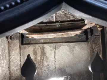

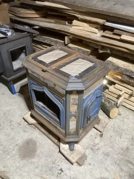

At this point I am keeping an eye out for a Woodstock Fireview or Absolute Steel or an equivalent made by Hearthstone. Fireviews seem to come up a fair amount, but it is hard to assess what is "worth it." Most recently I have found a Fireview that is 3hrs from me for $750. It is a model 205, and the guy got it in exchange for some furnace work for a friend. It looks fine as far as I can tell other than a new cat and the plate that is attached to the inside of the firebox by one screw. What do you think, worth it for $750 or pass it up and keep on the lookout for something cheaper or in better shape?

Needs a repaint, but that can be done with some masking and a brush. It doesn't look to be in bad condition via the pictures but check more closely for bypass operation and the combustor basket condition.
Looks to be a pretty decent deal to me. The combustor pan is missing a cotter pin, might be laying in the ash. Probably be a good idea to replace all the gaskets when you clean it up and paint. Woodstock sells a replacement gasket kit with full instruction.

"It is functional as it sits, but the catalytic converter (which makes it extremely efficient burning) bleeds by a little due to a warped bracket. This bracket is part of a rebuild/maintenance kit from Woodstock Soapstone company in Lebanon,NH." I am trying to figure out which kit he is referring to. This would do it, but it sounds like it would be a smaller part. I will give Woodstock a call today when I have the time.
I believe that the seller was referring to the stainless scoop, which is what is drooping inside the firebox. I can get that from Woodstock it looks like. I will probably want to get a rear heat shield and new cat, as well as a gasket kit. All of that will total $427.34, which brings the cost of the stove to $1,177. Not bad I guess. Other than a 3 hr drive each way :)

Just saw this thread. I think you did OK on this deal. Looks like the previous owner was hands-on, and did some work himself like replacing the older cast iron scoop with stainless, put a screw in the lid heat shield, may have patched the seams in the firebox, and probably other stuff. This suggests that the guy may have known how to run the stove properly, and probably didn't abuse it.

It looks like this one WAS a bit over fired.
I spent yesterday afternoon tearing it down and cleaning/patching/replacing gaskets. The previous user was hands-on, but could have benefited from reading the maintenance literature! In the above photos you can see the gasket for the bypass frame (W-161). This was applied to the joint with the combuster pan (W-160) and not in a place to actually make contact with the bypass cover (W-253). I suspect that this led to it heating up too much when it was supposed to be "catalytic" since there was still a draw through the bypass. The cover was very warped, which I suspect is a result of this over heating, and of course that just meant that even more air was let up the chimney. There was some general sagging of the center of the combuster pan, and there are two cracks that I had to patch with cement, which seemed like a good stopgap to replacing the whole part. They are out of stock of that from the factory, and it would have required drilling out the slotted bolts that hold on the top of the air duct cover (W163). This may have to happen at some point down the line, but I do not really see a particular advantage to doing it now. interestingly the are chute (W-172) was also a bit bent, but that seems like a nonissue.
Once I got the gaskets installed correctly for the new bypass cover and the combuster it seemed like the airflow would still go where it needed to. Luckily all of the bolts for things came out easily, with the exception of the ones holding on the air chute cover. The door latch was loose, and the last person had used some wires to tighten it up. I was not too impressed with the work, and ended up drilling at taping a bolt to be used to hold the parts together instead. I may end up grinding off one side of this bolt so that it fits better. Glass is out and cleaned, and now I only have one more gasket to apply around the top lid and I have to clean up the exterior. I will mask the soapstone and do Matte black for the metal, but do people have any recommendations of how to clean up the stone a bit? Deep scratches will stay of course, but it would be nice to make it a little nicer before install. Also, do people put any oil on it, or will it just get baked off? I was thinking something like flax oil may be best since it will harden as it drys.
