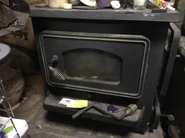

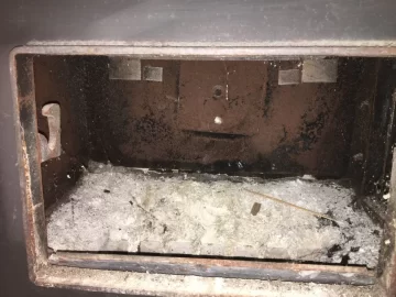

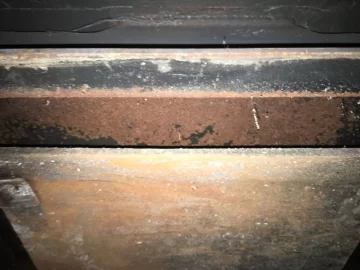

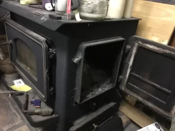

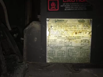

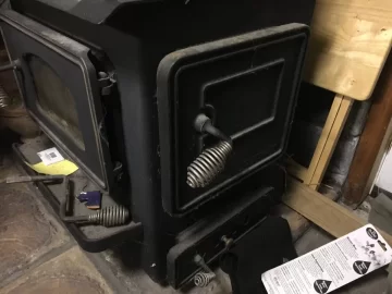

I'm putting and wood burner in my house. I was going to get a new one but just came across this old one. I will be getting it for free just have to get it out of there house. Is this burner a Catalytic or non? Everything looks to be in good shape probably will have to change the gaskets. So any information on this would be great.
[Hearth.com] Vansco Treemont [Hearth.com] Vansco Treemont [Hearth.com] Vansco Treemont [Hearth.com] Vansco Treemont [Hearth.com] Vansco Treemont [Hearth.com] Vansco Treemont
I don't think that model is catalytic. The TAC model was IIRC. Maybe @mellow can verify?
Wondering if the handle is for a shaker grate? Could this be a wood/coal model?
I believe that handle goes in the side and makes the bottom grate open up to drop Ash down into the ash pan but I'm not sure

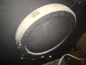

This is the top on the inside looks to be a steel plate that I'm assuming is removable I'll be able to see tomorrow and take more pictures
