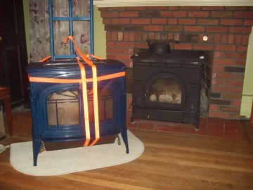

:lol: Here it is! All the parts are still off of it and I just moved it from the garage into the house. The griddle, fireback, flue collar, ash pan, grate, refractory hood and handles are still off! I was able to move it into the house by myself strapped to the handtruck. Used some planks to get it up the two steps into the breezeway then a piece of plywood to get it up the step into the kitchen! Now I have to clean it and wipe off any moisture that is on it from being transferred from a cold garage into the house.

Nice! Is this where the encore is going?
Yes it is, for now! I don't know where its permanent home will be. I had envisioned putting it in the basement once it is finished. But I guess I'll play it by year. Once it is in the livingroom I may not want it to go away. Then again it all depends on how it performs. The good thing about having it downstairs is that it would probably be able to heat the entire house better than the DW. If the numbers are correct! Then I can save the DW for whenever I want to be warmer in the livingroom, like the daytime, when the boys will be at school and nobody is in the basement! Another benefit of having it upstairs for now is i don't have to keep going downstairs to learn how to operate it. I want to know all the ins and outs before it goes down there. Thanks you again for the great moving tips! It helped a ton!

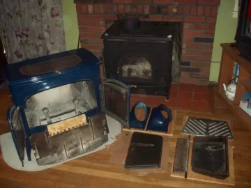

Sorry I didn't respond earlier, but I had a lot of work to do with the stove. I took the insides all appart and cleaned the whole thing, checking the refractory box and cat as well as other parts for any cracks or warpage. I'm pleased to say that the interior of the stove is impecable. The previous owner said he had replaced the refractory assembly once. I was sort of disappointed to see that the cat was cracked and warped, but I knew I may have to be replaced after I bought the stove. According to the previous owner it was 6 years old. But it looked really beat up for it to be that age. Everything was pretty simple to take appart. The thing that was by far the hardest, was taking the damper assembly off and putting it back in. Next time I'll make a jig to support the weight of the damper assembly while I take off and later re attach the bolts that go through the back of the strove and hold the heavy cast iron assembly. All the little nooks were vaccumed out and the cat was cleaned as best as could be. The stove is 90% clean and looks really great! I just have to dust off the little details that gather dust and are tough to clean on the exterior. There are only a few minor cracks on the enamel, nothing that can't be touched up with some paint from VC. This is a beautiful looking stove and I am happy to finally have it in the house. It'll have a chance to get acclamated with the indoor temps for the night and get rid of any moisture it may have acquired in the garage. I will fire it up this week with some break-in fires to reheat and take moisture out of the seams before a real fire is started.

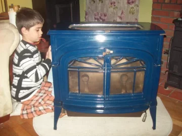

1. My little guy Max was hard at work wiping the dust off the stove!
2.The stove with all the parts that were taken out during the travel, this also represents the closest to the real color of the stove. It looks more Navy than the brighter blue the flash makes it appear!

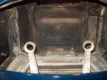

4.The cat is pretty banged up! Time to start looking around for one at a good price, I guess!

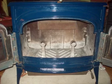

5.Inside the firebox with all the parts back in it. This picture makes all the dust on it really stick out. It had some ash all over it from having taken out all of the insides. Dusty and messy situation. All that stuff that looks like rust in the nooks and cranies is just dust. I already dusted off a lot of it, but it's hard to get at those inside corners. Again, the flash makes the dust really stick out like a sore thumb!

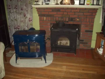

6.Here's where it'll spend the night untill I hook it to the chimney in place of the DW.
It was really tough to take that damper assembly off without something to support it while you try to unscrew from the outside. Even tougher to put it back in. Next time I'll have a little box built up to sit perfectly under it and put it at the right height without having to hold it by hand and try to line up the bolts from the outside.

Chris your stove looks like it is in good shape! Too bad about the cat that thing is toast! Unfortunately that's a 200 dollar item.. Ouch! I will consider cat cost a factor in my stove buying decision for sure as that cat cost double what my cat costs.. A major factor in my mind.. If you think about it stove costs aren't all that bad compared to what we spend for the wood that we burn.. I will end up buying 3 cords and just talked to my wood guy and he will hold the price of $185.00 per cord (a good deal in this area).. He told me the fuel costs were killing him and I believe that and he has gone up to $225.00 a cord but kept my price at $185.00! I think that many like me have to buy wood and I feel it is worth the money to buy it c/s/d.... Thanx for the great pics!
Ray
Yeah, I'm bummed about the cat myself. I was thinking of putting the stove in today and as I removed the DW from the fireplace and looked up the flue I saw more creosote build up than I'm comfortable having. So, I'd say it's a good time to clean up the chimney tomorrow. While the stove is out, I'll be able to get at the smoke chamber and get all the build up out of there. I also realized that the whole in the block off plate is too far forward. It should be back about four more inches. These are all things I've come to realize as a result of moving the stove out today. I must say I'm really surprised at how much creosote deposit is in the chimney compared to when I installed the DW. There was way more build up from November 30th to March 7th this year with the DW than the last two years combined with the box stove in the same location. I guess this is probably due to the cooler flue temperatures the DW gives off with the cat engaged. The old cast iron box didn't even have any baffles or dampers. A lot of the heat went up the flue. This probably allowed it to condensate less in the flue. But you can't compare the heat I got from the DW to the old box. It's like night and day. The DW heated the entire house all winter by itself, even with below zero temps outside.
Now that I think about it, the best thing to do would be to put off installation of the Encore. I have a brand new cat in the DW. It just doesn't make sense to put the Encore in with that old broken up cat. As curious as I am to burn the thing, it just doesn't make sense.
