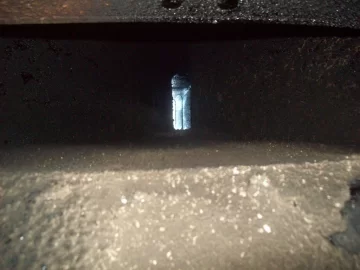

These are the pics looking up the flue. The first four I was laying down on the base of the fireplace. So the bottom of the pictures would be the part closest to the inside of the house, the top would be the side closest to the exterior of the house.
So I'll try to explain the pics:
1. You can see the clay liners (6 3/4" x 11 1/4" inside measurement) in the chimney just past the smoke chamber. But this sort of explains the lack of draft from this set up! The tile liners actually start almost 4 feet from where the top of the stove would be! This is a huge are for the smoke to circle around! The total length from top of stove to daylight is 13 feet. This makes it about 9 feet of actual tile lined flue. Despite this poor set up, my Dutchwest heated the entire house more than comfortably, even with below zero temps. This says a lot about this stove. It is a mystery to me that some people can complain about the Dutchwests.
2. This shows the fireplace flue damper closed. You can sort of see by the moon shaped smoke stain on the bottom of the picture that the whole on the block off plate is too far forward. You can also see the shiny streaks on the flue damper. They are dry to the touch.
3. You can sort of put the two pics 1+2 and see now on this that the flue is open. You can see the flaky spot that fell off.
4. You see the lintel where the block off plate connects from front to back. The center of the whole on the block off plate would be about at the center of the picture, just off to the left.
5. This is a pic of the surface of the block off plate that would be visible if you looked up the fireplace. It is down on the bottom of the fireplace. You can picture how the back side of the plate would just need to flip up into the fireplace.
6. This is the block off plate ready to be lifted into the fireplace. Although, next time it goes up it'll have a pipe going into the tile lined portion of the chimney at least.
So, now we all know how not to install a stove! Although it has gotten me through this winter it will not be operated this way again! I need at least a four to five foot piece of flex liner in order to come close to the manuals specifications. An SS liner would be ideal. This would still leave me three feet short of the recommended 16 feet required for either the Dutchwest or the Encore. So an extension would have to go up on top. Which only leaves me with a wind driven downdraft, caused by the giant pines on that side of the yard. I could use a vacu stack cap, to solve this issue.

Wow Chris that looks like a chimney with no clay liner! Your chimney is huge for a wood stove and you definitely need a 6" insulated liner there.. I would think you have a lazy draft with that setup combined with less than seasoned wood adding up to creosote.. I think you'll see a big improvement with an insulated liner in that situation.. I know adding that insulated liner here made a world of difference even though I had a 7"x7" ID square liner and I feel you'll benefit in much the same way that I did here.. Improving the draft makes all the difference along with seasoned wood I will say that! Thanx for all the great pics too!
Ray
Ray
+1 on adding the insulated liner!
I can't believe it actually drafts like that. If/When you put the liner in you will probably notice a huge difference in the stove performance.
On a side note I'm extremely disappointed to not hear your review on the Defiant performance. I am still looking at a new stove and the 2in1 has my interest peaked quite a bit so I was looking forward to a comparison of the Dutchwest and Defiant side by side.

Ray, please scroll back a few posts and see what I added explaining the pictures. The chimney is lined, but the tile liners don't start untill after the smoke chamber, about four feet up. I knew it needed a liner, but it wasn't until today, after measuring to the liners that I got a better picture of how badly I needed it.

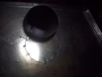

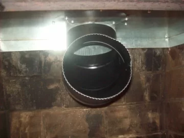

Well, I didn't line the entire chimney yet! But, I put in a pipe extending 4.5 feet up from the top of the stove into the tile lined section of the chimney. It was a tough job. I got rid of the fireplace flue damper, by just removing a cotter pin and pulling it out completely. The chimney was swept from the top down and the smoke chamber was scraped with a stiff wire brush and the chimney brush connected to a rod, from the bottom up. What surprised me the most was the amount of debris that had gathered behind the fireplace damper. Altogether, I filled about a gallon of a 5 gallon bucket. Of that gallon, only a quart came from the chimney and smoke chamber. The remaining 3 quarts came from the smoke shelf behind the damper plate of the fireplace. I found a pine cone and even a couple of leaves in there! Every time I looked up into the chimney, it looked clear and clean. Little did I know there was a ton of stuff hidden in that shelf. I removed most of it by brushing it down with my hands, the vacuum got the rest out. In addition, I moved the whole on the block off plate in order to line it up with the chimney better. The first fire in the DW, or in the house for that matter, since February 26th is burning right now! I missed it so.

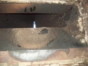

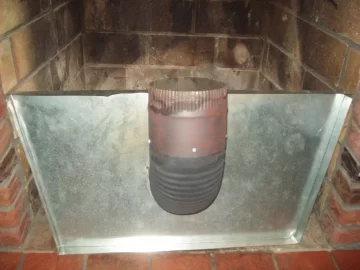

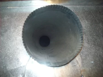

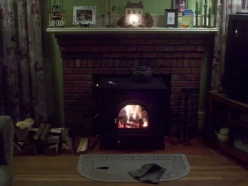

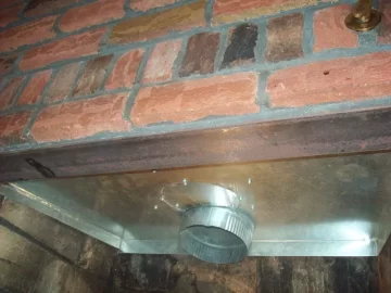

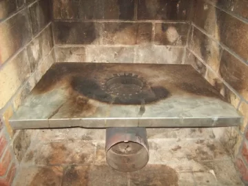

Here are some pictures I took after the clean up. They were all taken after the block off plate was placed back into the fireplace.
1. You can see the offset whole, patchwork on the tin and the pipe sticking down from the block off plate.
2. I tried to take this one so you could see up the pipe.
3. get a better view of how the block off plate fits in the fireplace
4. a brand new 90 goes into the new pipe and is ready for a stove!

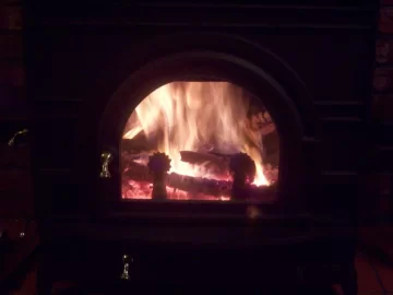

5. OK, I know how you guys like to look at the fire. Post cleaning fires are the best!
6. Alright, I'll add one more, twist my arm!
Sorry I'm such a bad photographer!

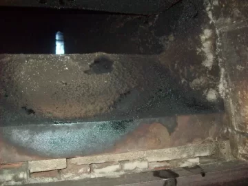

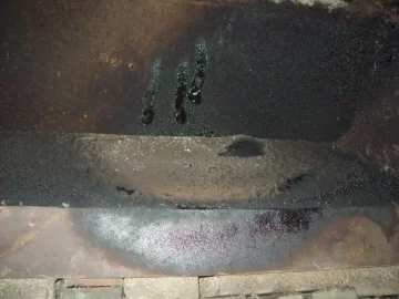

That seems to be about as much as I get from the Vigilant.
BrowningBAR said:
Wow! This chimney had not been cleaned since I moved in in 2007. Of course, I burned about two cords in it as a fireplacxe the first winter. The second and third winter, I had the Atlanta stove works old cast iron box in it. Burned about 4-5 cords in it then. This year, the DW created more build up due to some people, who I won't mention, trying to load wood into the stove with the damper down, YES the damper was down. Wife and I were out and the babysitter tried to load the stove one time. The other time it was my mother in law. They were both experienced burners on non EPA stoves. Both had operated thermostatically controlled Surdiacs. Neither had ever operated an EPA stove and ended up clogging my cat! It took a few times of really cranking up the temps to detox the cat each time. I could only imagine the smoke that came into the house! By the time I came home I could only smell smoke. I told them both NOT TO TOUCH the stove. They didn't listen. But yours makes this much mess huh?! No wonder you want to replace it. The thing must chew through some wood no?

Just to be clear, I was referring to the "gallon" part. Not "5 gallon".
Somewhere between this:
[Hearth.com] VC Defiant Encore model 2190 Long thread! Pics Dutchwest re-install!
and this:
Which is interesting because when I go up to clean the chimney I can see a LOT of the stainless-ness of the liner when I clean it. Hardly looks dirty. I'll try to take some pics when I clean it this year.
