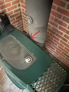

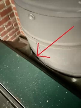

My questions is: Should the Flue Collar to vertical flue pipe be sealed? As seen in the pics I can see flames through the crack and I hear whistling when the stove is not in Catalytic mode. I did an incense smoke test and I did notice that this area does suck in smoke when the fire is going.

That gap can be sealed with some flat stove gasket, but it may not change the short burn time. How tall is the flue system on this stove?

A leak in the flue system won't cause the issue you described, if anything it would decrease the draft and slow down the fire. But I don't think a gap that size would be anything to worry about.

The fact that I can see flames through this (when NOT in catalytic mode) and not when IN catalytic mode has me thinking it could be the damper seal. I do have to fiddle with the damper lever a bit to get it to stay shut... almost like I need to slam the damper closed or else it will fall back open. I'll have to tear it down tomorrow and take a look at things.

That makes sense. With the bypass open, the flame path is direct to the flue.

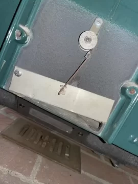

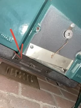

Is this one of the stoves that has the primary air intake on the back corner? there's a ball chain that lifts up a flap and you should be able to hear it "clink" shut when you turn it down.
I think this is the part that moves when I adjust the air intake.

Thomas, no. Older V.C. stoves had those. Justin325 that's it, primary air flapper thingy. I would look closely at the ash pan door to be sure it's closing securely and seals all the way around. Encores are notorious for ash pan door issues. Also tap the glass panes. If they rattle at all, regasket them . Another classic Encore problem area

I'm fighting a very similar issue, but my adapter pipe is on the outside of the flue collar, installed incorrectly. I would definitely seal that sucker as a first easy step. For me, I get to wait for the installer company.

Could you still see the flames through the collar with the bypass closed again after tinkering with the internals?
