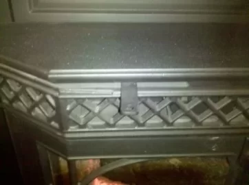

anyway i took a picture of what i believe is the fully open position for the primary air control - see below.... am i correct on this?
second question - the automatic setback control? if u push further to the left it spring back and then according to the instructions ur supposed to hear a clicking sound of it closing? i never hear a clicking sound and what does it exactly close?
so basically my questions are is the pic below of the fully open position or should i go more to the right, exactly at the corner? also what the hell does the automatic setback control do?

Mica,
Judging by the photograph that looks like fully open to me.
Now, what the automatic set back control does is this. When the stove is sufficiently cool, the set back mechanism can be used to set the damper to full open and hold it there while you adjust the regular damper control lever (pictured in your picture) back to the setting you would want it to be when the fireplace comes up to full temperature. Then the internal automatic setback control mechanism releases the internal damper control and you hear a little spring releasing as the damper then comes back under manual control and ends up at whatever setting you left the manual lever set at.
So here is an example of the operation. You let the fireplace burn over night, you wake up in the morning and it is pretty cool, you decide to re-load it and then go to work. So you reload the fireplace fully, slide the manual control lever all the way to the left (to set the automatic set back control in the full open position) THEN you set the manual damper control back to fully closed (all the way right). What will happen is that the damper will remain open because of the automatic set back control while the fire gets re-established and the fireplace heats back up. Then when it is burning nicely and the fireplace is heated, the spring will release and the damper will go back to the manual setting (fully closed), this will keep the fire burning nice and slow while you are away at work or whatever.
Without automatic setback control, you would have to leave the damper fully open to let the fire get re-established, then close it after an hour or two so you can prolong the burn. Sort of a bummer to have to drive home from work to adjust the damper on your stove.
Does this make sense?
i think i got ya,
so basically when starting a cold stove, pull the lever all the way to the left, past the pic i posted until you hear the spring then pull it all the way closed. after the stove heats up it then closes itself automatically and you will here a click - according to the manual?
If i am correct what temperature does it take for the setback control to close? the fan coming on?

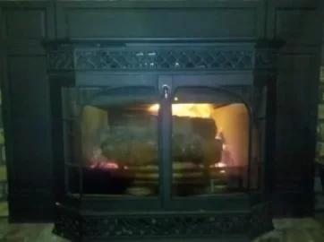

It seems there's been a lot of discussion on the windows getting dirty. When I first started burning I kept the air control fairly low and the windows got "sooty" pretty quickly. I've opened the air control up a little more (about an inch more to the left) and it made a world of difference. The fire's hotter and there's not as much smoke to cling to the windows. I also think that the increased draft makes what smoke is produced flow away from the windows, which is the air wash doing it's job. Also I will add that my firewood has only been cured for about 6 months, which is not ideal and probably adds to the problem. But anyway if your windows are getting dirty, increase the air control a little bit (move it to the left). We've had a hot fire burning for 3 full days now on the same air setting and in my opinion, the windows look pretty good for that much burning. I think there's always going to be some window cleaning to do, but overall I'm really impressed with this air wash system. And the water and ash method is the best way I've found to clean the glass. My 11 yr old daughter does it in about 10 minutes.
As far as starting a fire, I put the logs right on the floor of the insert, stuff a few pcs. of newspaper between them, open the air control all the way to the left and light the paper. I leave the right door cracked open about an inch to get lots of oxygen rushing in there. I'll have to add paper once or maybe two more times, but it usually lights pretty quickly like this. No kindling or anything. Leave the door ajar for 20 minutes or so until the woods burning good, then close it and set your air control and enjoy. The blower takes about an hour before it will get hot enough to come on. There's no way to turn the blower on manually. Once the fire's burning good and hot, I don't even change the air control when adding logs. Just open the doors slowly to keep smoke from coming out into the room.
I'll load the firebox up and it'll burn good for about 4-5 hours. I thought I would get longer burn times, but it seems others have had this problem too. While I don't load it all the way up to where the wood is hitting the tubes, they are pretty sturdy if you bump them. The baffle on top of the tubes, however, I am careful with. It seems somewhat fragile to me, but I don't really know. It reminds me of a grinding wheel type of material, but it's VERY lightweight. I don't know how much abuse it could take.

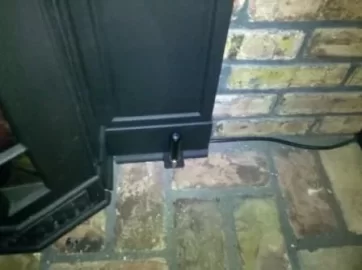

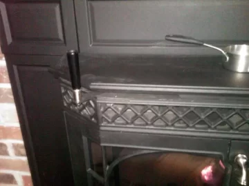

I'm going to try and put a few pics on here that I just took. One is of where I have kept the air control lever as this fire has burned for the last three days, and one is how the windows look with that setting. Another is where the blower cord is routed, just because there's been some discussion about that as well.
Sorry for being long winded, but maybe it'll help someone.
