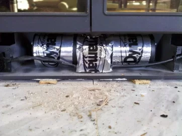

Here is the report after my initial attempts at noise reduction. After some consideration of the options available I decided to use Dynamat vibration / acoustic absorbing material. I used 5x 4"x10" Dynamat Xtreme utility pieces. See the attached picture. 1 piece each was wrapped around each blower housing and 1 piece was draped over the motor assembly. 2 additional pieces were attached under the bottom sheet metal to attempt to deaden its vibration.
The result is a net 3dB(A) reduction in sound. At 100% fan speed the highest volume level is about 66-67dB(A). It is noticeably quieter, but nowhere near my goal of <50dB(A).
As I thought about it more, no amount of acoustic insulation is going to adequately quiet a noisy, poorly balanced blower.
So the bottom line is that I am pursuing the design and fabrication of a completely new blower assembly. It will be based on a different fan technology that should be much quieter. I just can not have that kind of noise next to thousands of dollars of home theater electronics and speakers that I really enjoy listening to in a warm house.
Hopefully I will be testing a basic prototype in 1-2 weeks.

Referencing the above picture don't forget to clean the intake grills on each end of the blower. It is like cleaning the lint from a dryer screen, just not as often.
