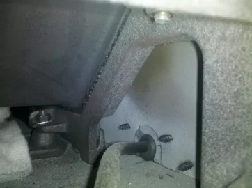

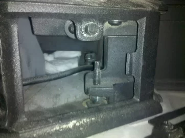

Here are 2 photos of the wiring in my Merrimack. The first shot "Merrimack Wiring" shows the view through the right side (when viewed from the front) little magnetic access door. You can see the wire going from the blower on the left toward the hole on the right. The 2nd photo "Merrimack Wiring 2" shows an interior shot of the wire passing through the sheet metal hole with the rubber bushing in place.
Unfortunately, I was not willing to go through the trouble of removing the cast iron surround so I could shoot a photo of the outside of the sheet metal on the right side so you could see the actual hole the wire comes out of. That is a pretty big project and it took me quite a bit of tinkering to get the surround on perfect with the insert pushed back flush against it. I am not willing to wrestle the 480lbs beast again.

Nope... The hole and cover plate where there from the factory. The only drilling I had to do was in my actual fireplace to get through the old firebox and into the vent and then outside of the vent to get to a power outlet in the room. To reiterate... I did no drilling or modification of any kind to my VC Merrimack. I believe the cover plate to that hole shown in the 2nd photograph was on in the closed position and then you unscrewed it, flipped it over and then screwed it back in and then it has the hole. This is a VERY common way that electrical appliances permit cords to pass through sheet metal.
perfect i see what u mean now, the guys covered it putting the surround on. well they gotta come back anyway as the surround peices arent flush.

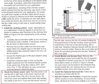

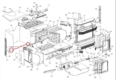

Here are some excellent diagrams from the Merrimack Instruction Book. It is not perfectly obvious but given the red circles I put on the diagrams that should help.
You are correct, the hole for the wire to go through is behind the surround. I bet your installer is going to be really surprised when he realizes you want him to route it through that hole properly and find a way to get it out of the existing firebox. This is no trivial feat and depending on the installation can be one of the most difficult parts of the installation. A friend of mine had to hammer-drill through 8" of concrete and brick to route his power cord. Let's hope yours is easier.
