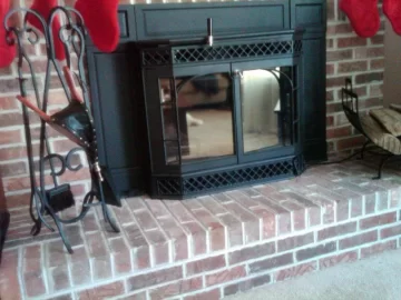

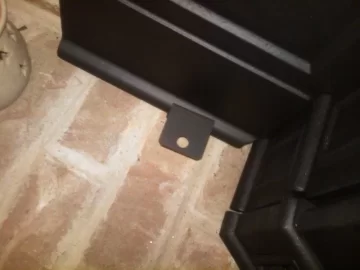

btw the pic below the installer said this was an extra peice for the handle? where do you guys used this at if at all?
Thanks chunk, I will try it. btw i forgot to attach picture to my last comment. here u go.

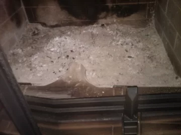

Also guys how deep do u have ur ash bed and i know the ash bed protects the floor but does it also help raise the temp in the merrimack? i took a pic of my ash bed below.

Musky, dont tell me those legs should be elevated? are the cold bricks a reason why its not heating up quicker? another pic below.
please let me know as i have the installers coming out thur morning to route the blower power cord, i can get them to readjust if so.

my ashes can get 3" to 4" deep. I don't keep a thin layor to protect the bottom when I clean the ashes. Should I?
There is a "air hole" at the end on the center stone that you are to keep clear of ashes (see manual). Almost Impossible. I can't believe this is connected to the blower? See what you installer says.
oh musky to your ashbed question, thats what the dealer told me no idea if its true or not. ill check to see what the installer says but if its the same ones that did the first install it will probably be useless as it was their first merrimack install and they just seemed to be the type to throw it in and then u figure it out. most of my info has come from this forum thread.
