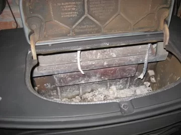

Vermonter2011 said:Gang - this repair turned out to be far more complicated - the damper assembly had to be disassembled to repair the gasket.
The repair guys found that most of the gaskets hadn't been properly cemented when they took the stove apart - see my new post with the follow-up to my story here:
https://www.hearth.com/talk/threads/69925/
I hear what you're saying about having to replace the gaskets after only one month!! However, I've seen brand new stoves in the showroom floor that have less than perfect gaskets. This is just something that people have to look out for when purchasing a stove. I know what you were thinking. I just bought the stove and am not willing to do maintenance type repairs to a brand new stove! Right? You thought you shouldn't have to! You were probably right. But, Vermont castings shouldn't have to pay for the gass and time for your dealer to get to your house, right? The dealer sounds sheisty, very sheisty!! Your post should have been titled BAD STOVE DEALER STABS YOU IN THE BACK TO DO A SIMPLE GASKET REPAIR! That being said. I would never pay someone $100 bucks for doing a gasket repair! If you're willing to give them your dough, you must not be broke from it. Replacing gaskets is easier than replacing the screen on a screen door! You're supposed to check all the gaskets at least once a year and replace if need be. I would certainly learn from what your repaiman did and get prepared to do it next time.
