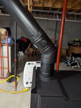

The 375 flue temps were external using an IR temp gun right above the first 45 elbow, about 22 inches above the stove.
You can see the setup in the attached photo.
