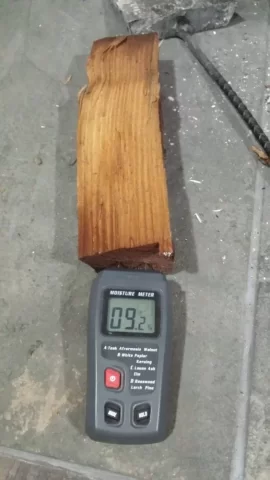

Besides a test burn after cleaning last month today is the first burn for me.
Is everyone ready?
I got about a chord of Mulberry, that I love so far(9%) some walnut, another cord or so of dimensional pine, as well as a steady suply of dimensional pine.

Are you saying 9% moisture content? How dod you measure that? And how was it dried?

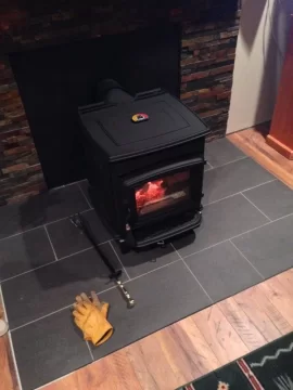

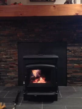

Thanks for the welcome @Blazing . I've found that a box fan on the floor blowing cool air toward the room of the stove does indeed work well. It tends to push the warm air along the hallway ceiling and up the staircase.
I've been running the furnace fan occasionally to try and mix the upstairs and downstairs air with some success, but I could see how heat would be lost in the process as you mentioned. I'll keep experimenting and see what methods work best.
Some background info on the stove installation:
- House built in 2004, 2 story, 3 bedroom 2.5 bath, 1500 sqft, "townhouse style"
- Wooden exterior chase (chimney is at least 30' to top haven't measured exactly)
- Existing zero clearance fireplace, damper removed and 6" flexible class A liner installed inside zero clearance chimney (professional install by top installer in county with 35 years experience, county inspected)
- Front of existing zero clearance fireplace blocked off by steel plate
- Tile hearth with cement backer board (built myself to meet clearance requirements)
- Short leg kit, no blower fan on stove
- No outside air kit
Its only been a few weeks but it drafts strong and I haven't had any issues. Looking forward to a warm winter!

Are the vents of that zc fireplace closed off?? If so that could be dangerous.

That is very nice looking!

Not that I'm aware of. I was out of town for the install so I wasn't able to see exactly how it was done. In our area you see this kind of installation more than you would think due to all of the zero clearance fireplaces with wooden chases.

I understand it may be common but the vents for cooling air on the face of the zc firrplace need to be unobstructed. And from your pics i dont see how they could not be.

The steel plate isn't sealed off. There is an air gap at the bottom (maybe an inch) and a small air gap around the edges. It appears to sit away from the face of the zero clearance stove (not sure if they removed the old brass colored face or not). I agree you would want some air to flow inside to cool the zero clearance chimney.
The 6" liner sits inside a 8" double wall chimney and the chase is about 4 feet wide by 2 feet deep.

Ok if there is a gap it is probably ok. It just didnt look like it in the pic and i wanted to make sure it was as safe as it could be.

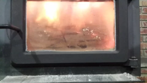

Oh how I love up side down fire! Night 2, for no reason other then novelty :-) I'll probably regret this in March when I'm cutting up pallets... lol

Yeah test on the fresh split face not end grain that is why your reading is off. It is probably dry enough but not 9%
