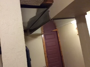

Here is how I did my roof shielding that had to step down to cover a duct.
