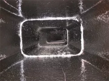

I guess I am the only one that thinks a layer of shiny hard stuff is glaze creosote. It sure was when it happened in my chimney.
Thats what I was thinking. I suppose its probably too late, but a picture would really help to confirm.
That's what I was thinking. Black, shiny and on there like a coat of paint isn't a good sign from what I've read on this forum. I understand that it's the hardest type of creosote to remove and burns the hottest.

BrotherBart, that's what I'm unclear on. Is that degree of creosote that shows in your picture dangerous? It looks like a very thin layer and I thought I read it needed to be thick and flaking off to be bad. Will that thin layer ignite? Did it? I'm confused.
Yes it will ignite. It isn't thick enough to create a huge chimney fire but if he is still burning it will just continue to build. I in no way suggest that anybody do it but in order to clear that chimney out before installing my liner I intentionally set that stuff off. It was a hot smokey mess and left a pile of popcorn burned creosote in the fireplace firebox.
At the very least the OP needs to start using Anti-Creo-Sote to soften that stuff up and make it where he can brush it out of there. Best would be a sweep using chemicals to remove that stuff. because it is in any cracks and mortar joints in the chimney too.
