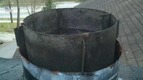

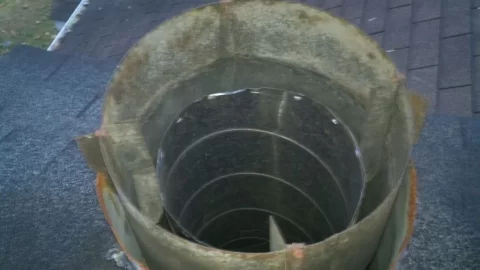

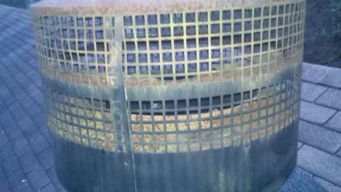

I'll have step by step pics. I'm gonna have to do some engineering on the hearth since it's not flush with the firebox opening, but I have a plan with some angle iron. I'm having some real issues with what to do at the top of my chimney. It's triple wall stove pipe...large. Inside diameter is 9 and 3/4". Only the second wal goes above the roof line, about 12 inches, and it's outside diameter is 13 and a 1/4". I don't really have the money to have something custum made so I'm trying to come up with something.

Here's a few pics of what the top of chimney looks like....yuck.

Wait....Sycamore dries fast!!!!! I cut some last November and it is dry as a bone. You have to tell us more about the chimney. And what did the Lennox/Country Stove Performer C-210 go in?
