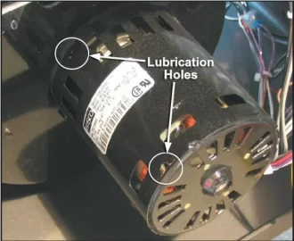

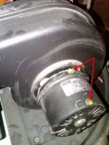

As for your convection blower, have the bearings ever been oiled?

You know where the oil ports are?

20w non-detergent oil.....regular red can "3 in 1" oil will do in a pinch. If you get to the hardware store, try looking for 3 in 1 oil in the Blue can....that's made just for electric motor bearings.
Put 3-4 drops down each oil port.
