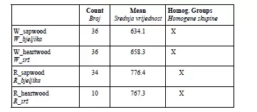

BTW - Density of sapwood vs heartwood was found to be statistically insignificant according to this study: hrcak.srce.hr/file/166363
The multiple
range test (95 % LSD method) (Table 2) showed
that the differences between
[densities in] sapwood and heartwood
within white and red oak groups were not statistically
significant.
Table 2 Multiple range tests (95% LSD method) of sapwood and heartwood oven-dry densities of W_: white oak and R_: red
oak
