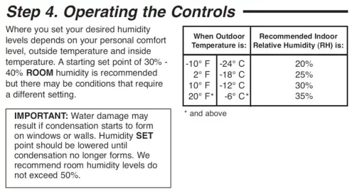

Here is what they say in the instruction booklet:
  • [Hearth.com] What is a "normal" humidity level and how to achieve with an insert?

50% is indeed optimal for your sinuses etc, but in the winter when its cold outside and the walls/windows are cold you can get condensation that encourages mold. This is why there are charts that provided suggested humidity levels relative to outdoor temp. The colder it is outside the lower you want your humidity.

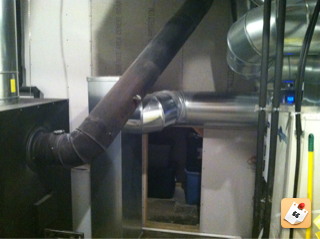

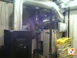

I have a forced air wood furnace. Keeping humidity is a real issue.

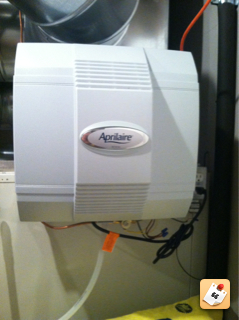

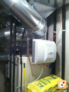

I installed a humidifier on the plenum over my geothermal unit. I decided I didn't want to have to refill a humidifier every day for four months out of the year.

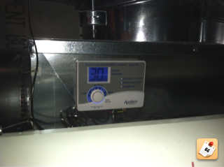

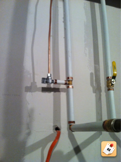

As was posted above, humidity levels need to adjust with outside temps or you will get condensation on the insides of your windows. The humidifier I have has a temperature sensor that runs to the outside of the house. This senses the outside temp level and adjust the humidity level automatically. It really works well. You need to tap into a hot water line and have a drain line for excess water. Some have an air return on them. I didn't want more ductwork so my unit has a fan built in that forces the air. I'll post some pics...
