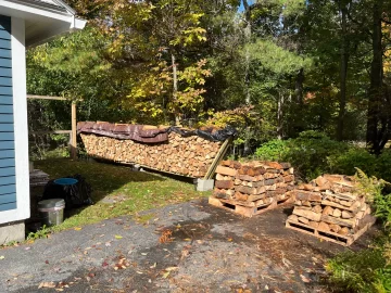

Done!

Perfect!
Mind those tarps over time. Sun and weather will break them down. Water will puddle in the low spots due to the hills and valleys created by the uneven wood below the tarps. Eventually, as the tarps break down, those puddles can seep into the wood below creating wet wood spots. If you can find some used pond liner material, that stands up much better and longer.
I learned this the hard way one year with maple stacked for 3 yrs. under tarps. The problem showed up early in the burning season. It's the only time I have had serious creosote buildup in the last 30+ yrs. and that happened within a month.
I find it as used "flat roof" material much more often. EPDM rubber.
