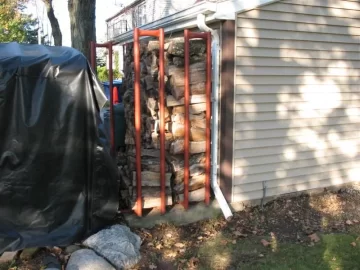

Work for a metal shop. Had one of the guys weld me a wood seasoning rack. Going to pour piers for the post supports at some point. Just needed to get the wood off the ground this winter. Currently have 4 of them. Each holds 2/3 cord of wood. Does not look to stable from the photo but with the 40 mph winds we had recently it is still standing. For some reason I cannot upload the front view. Going to build a couple more as soon as I find more wood.

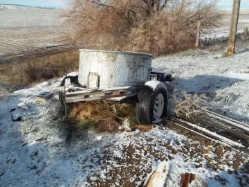

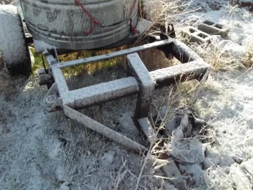

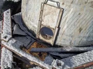

I realized I can use this tow mixer to make 'bio-bricks', I think. I haven't did it yet, but I'll try it and it should work.
The machine: a round livestock tank, a frame with differential off of a pick up truck (rear wheel drive), lawn mower blade, irrigation gate/door, tow hitch and some wood framing.
How it works: the differential is repositioned from horizontal to vertical. And a lawn mower blade is attached to the now vertical differential. When towed the differential spins the lawn mower blade with great force - i.e.a big blender. So put a 100 or so gallons of water in it, newspaper (or cardboard) and wood chips if you have them. Now tow it for a block or two and turn around.
Now you have a grey slurry. Open the little irrigation door and start filling 5-gallon buckets. Dump the buckets into forms. I am thinking of ways to compress the "bricks". I think I will try to make a form that I can roll over with a pick up truck to compress the oatmeal-like slurry. And maybe figure out something to throw in the slurry to make the bricks smell good (like a crystal incense?).
After a day, remove the forms/ And you have a wet bio-like brick. Stack them and let them dry like regular firewood. I have no idea how they will burn or what their btu rating will be. I did make some just paper slurry with no compression and I was surprised at how solid it dried into. This is a good use for newspaper and wood chips. Probably make good shoulder season stuff.

Hmmm...the results will be interesting. It does sound like a somewhat energy and time intensive project. Maybe compare time/energy to produce these bricks in relationship to time/energy used in producing firewood??
The hardest part is toting full buckets of 'mush' to the forms. Everything else is just time consuming - gathering newspapers and chips, taking off forms, compressing, stacking, etc..... A person could probably rig up a chute or conveyer to move the mush into the forms. I'm guessing you could get about 1/3 to 1/2 a cord from one mix with the system I have.
byQ, I'm impressed with your ingenuity! I would be interested in seeing the wood heater of a fellow Idahoan. (I sent you a private message in this forum tool, but not sure you saw it yet)

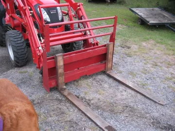

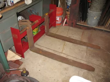

Pallet forks and grapple attachment. It is used for loading and unloading logs, holding the logs at a comfortible hieght when bucking,and pileing brush. Forks for the 3-point. A 1/2 cord wood tote for the 3-point.

Got the forks, got to have the tote! Need something to get the wood out of the woods, been using my skid loader but it's not real good in rough terrain. What kind of tubing did you use?

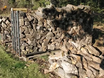

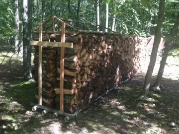

My wood pile design.

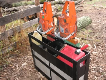

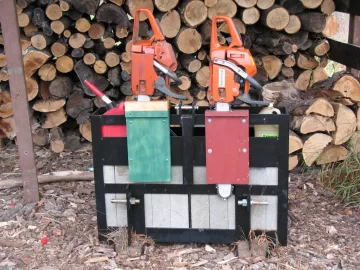

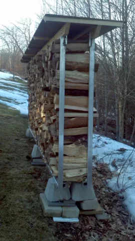

Found that ballast helped when loading logs. Fireplace wood racks

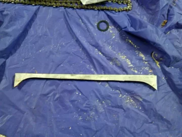

So here is one of my homemade tools that I brought in the other day and took a picture of tonight. I use this to set the length of my firewood. It is 16 1/16" long. Hammer it in, them move down, repeat. Cut at each mark that it makes. If I can get logs or whole trees, my wood pile looks REAL pretty :)[Hearth.com] Who here Makes Their Own Firewood related stuff?
