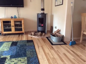

As some of you may recall we bought a Fajardo Ronda Woodstove a short while ago.It took a while to get it installed since we first had to build a new hearth pad made from tiles.At this point the stoves is all hooked up. We have got a external chimney which is about 16' and 2' over the peak of the roof,it's made out of triple wall insulated stainless steel.
We had a certified chimney sweep inspect both the chimney,the stove and stovepipe,he said that everything looked great! The problem is that we can't seem to keep the fire going after the stove door is closed. Strange thing is that we had the same issue with our Vermont Castings stove but that was at a different house.

The dog still seems to enjoy the smoldering fire....
There is one clean out T and 2 inside and 2 outside 30 degree bends.Chimney height is 16' outside and 4' of stovepipe inside. It doesn't seem to make any difference when moving the damper in the front of the stove.
Yes,our dachshund Willie does enjoy a 'Wieny' Roast ;-)
