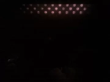

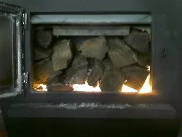

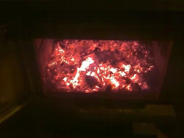

mhrischuk said:
How does turning the stove way down keep the cat hot?
As long as the cat lights off before you turn it down, the gasses flowing through the cat keep it lit at low burn. I fully load my 4.3 cu ft stove every time regardless of how cold it is. If I need little heat, you will see what looks like a dead fire but the cat glowing. If you want to throw some heat, you get a light show. Rate of burn dictates length of burn. I find burning 24/7 makes the process much easier. When you reload on a hot coal bed, the cat easily lights off in a matter of minutes after the reload.
  • [Hearth.com] Why didn't you buy a cat stove?
