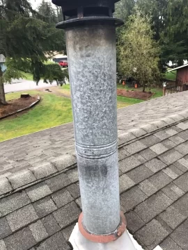

Here's a picture of the outside I need to go in the attic to see what all is in there as I don't remember exactly what it was.

I wouldn't be surprised if it is galvanized it most likely was installed in 1980 or something around that time.
Lopi Rockport
The jacket is galvanized and doesn't appear to be corroded, but that should be checked out. The liner in the chimney should be stainless. If it is in good shape then I would clean the exterior up, wipe it down with alcohol and paint it with something like Rustoleum BBQ paint.
FWIW the roof doesn't look too bad either, but the picture only shows a portion of it. You can still buy galvanized chimney pipe today, but if the roof is replaced this would be a good time to update the chimney.

Never seen stainless look like that. It almost looks galvanized.
It is galvanized exterior and I agree with begreen it does not look like it is in bad shape at all from the outside. I would have it inspected and if everything is fine paint it. Galvanized exterior is not what I would choose to install but you have it so you might as well use it till it starts to deteriorate.
Reactions: Tegbert
You can also just lift out and replace the chimney sections if you want and leave the roof flashing. Fresh stainless steel is really shiny and pretty!

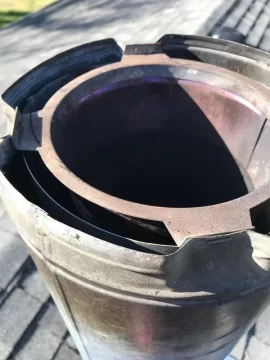

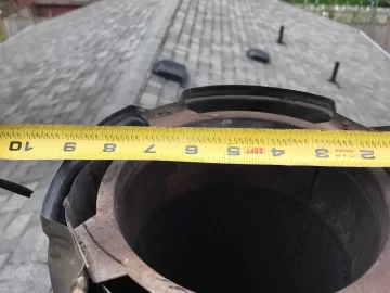

So I took a couple of pictures of the chimney. I like the idea of painting it and she probably would go with that.

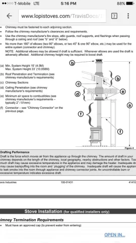

Problem is I just measured the height and it is at 13' 1" from the top of the stove to cap 15' 3" to the bottom of the stove. Lopi says 15' minimum but there diagrams have the line to the bottom of the stove if that's the case I have 15' but not from the top.
[Hearth.com] Wife wants new chimney

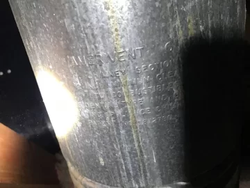

Looks like it is amerivent pipe
Lopi Rockport
Ok well Iwould change that out it is an air cooled chimney not an insulated one they do not give you very good performance.

As far as the 15' thing, since lopi measures from the floor and requires 15', so long as you measure the same way and get 15'+ then you meet the requirement. Different manufacturers measure this differently which is why they gave you that nice diagram.

You may need to, including the flashing. Air cooled pipe has a larger OD than insulated pipe. Measure the OD to see if it's 8" or 10" If the OD is 10" then you might as well paint the current chimney for the short term if you're going to keep it for a couple years and replace everything when the roof is done.
