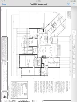

Here is a pic of my downstairs. I was thinking of putting the add on in the narrow garage/shop on the outer wall. The furnaces are in the attic above the garages.

I can't quite make out your floorplan. But more so, I think your first step is to determine if you can run practical and acceptable ductwork (one large hot supply and one large cold return) from your shop to your living space. If not, then you needn't worry about the remaining requirements with a furnace. It sounds like the chances aren't good that you can run acceptable ductwork?

It would be easy to run a supply to my main furnace. I don't know if I would need to tap into the existing return or not as I don't know the ins and outs of ductwork. I did make my hvac guy run returns in each room when we built the house because he was just going to do one central return. The shop is insulated if that makes a difference on the performance. I know people have outside wood units but I am trying to see if there is a stove I could use in my shop to heat the house. Much better to walk through a heated garage to load wood than outdoors!
