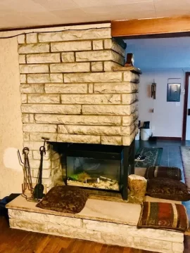

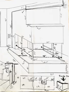

Hi all,
I am new here. I have been trying to learn as much as possible but still seem unable to find the right answer. Most retailers want to sell what they have in stock or what they guess you can afford, and they are not so open to answer questions. What we need is to insert a wood burning insert into a peninsula fireplace. We are trying to heat a 2,700 sq. ft. 2-story home, we estimate we need at a minimum 65,000 BTU's and over 75% Efficiency rate, at least 8h burning time, with blower, hopefully good emissions rate, EPA certified and ideally lifetime warranty, auto off, remote and thermostat, and a nice size viewing window. Door should be on the left as shown on picture and effective opening is 37 w x 27 h x 26 d. We are fortunate to have a person who can either put a plate on the two other sides or build a masonry around to fit the insert without modifying the actual fireplace structure. We initially looked onto installing a gas insert but it seemed complicated and not as efficient but if someone here can make suggestions we are also still open to this. We are in the Catskills so it is starting to get really cold here so any help will be appreciated.

I can say that there is no insert that will tick off all the marks mentioned. Some compromising will be necessary.
Put in the biggest insert that will fit in there and connect to a fully insulated 6 or 8" stainless liner up the chimney. That and several cords of dry, fully-seasoned firewood should warm things up. Start with looking at the Buck 91.

Can you tell us a little about your homes layout?
There is a small floor layout plan in the dimensions sketch. Looks pretty open.

Putting out enough BTUs to heat your house is one thing. Getting that heat distributed through your house from a single point heat source is a whole different issue.
What do you mean by auto off and remote btw?
For distribution, I was told I can put fans running behind the stove in the direction of the stairs moving cold air, i can install reverse fans upstairs and even vents that connect the end of the 2nd floor to the 1st in a loop like manner.
Thanks!! Begreen is right there is a first floor layout in the diagram. It’s very open area. The stairs to the 2nd floor face the potential insert opening and as you are in the 2nd floor, you can go right to a small room, straight to a large bathroom or left to a very large main bedroom which also has a very large studio further down.
The auto is for sensors and self stop if the room temperature reaches 80 degrees or starts when below 65 or say I want it to stop at 5 am and back on at 6 pm. Not sure it is realistic expectation but who knows what’s out there.The remote is for whatever functions I can get. On/off, vents, temp and what not.
