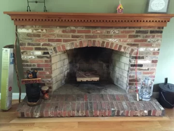

Hi Everyone,
I want a wood insert that works with the room and the fireplace opening, that heats the house when the power goes out, and can boil water for cooking if there's no electricity.
Qualifications:
- Our living room is narrow, and we don't have much of a hearth, so we'll need a hearth extension for anything that isn't flush, which is fine. But we don't want something that sticks out super far.
- Our fireplace opening is 51" wide x 33" high. It's 24" deep at the bottom and 18" deep at the top. The current hearth is 17.5".
- Our house is a colonial (basement and two floors) that is 2600 sq. ft. The insert will be on the main (middle) floor.
I've zoned in on the Quadrafire 5100i ((broken link removed to http://www.quadrafire.com/Products/5100i-Wood-Insert.aspx?page=Downloads)) because it has a ledge on which you could set a cast iron pot to heat water, it has a decent amount of viewing space (windows), and it will produce a lot of heat. Also, it's fairly big and won't look ridiculously small in in our large fireplace opening.

Your fireplace is both beautiful and huge! Have you considered hearth mounting a free standing stove instead of an insert? You would fix a couple of your concerns,i.e. A big enough surface to both cook and boil water on top.
I've never been able to boil water on any woodstove myself. If water reaches the boiling point, I'd be worried that my stove is overheating.
Thanks for writing. Yes, we thought about it, but the dimensions inside of the fire place actually don't allow for a stove that would provide the heat output we're looking for. It's wide, but it's 33" tall and only 18" deep at the top. (The back is angled going up.) We want to be able to put a cast iron pot on it to create humidity in the room, so we need a ledge that is outside of the opening. And, we'd like to be able to cook on it if we had to. Our hearth is not deep (17.5"), and our living room is fairly narrow. So, we don't have much room to work with. With the insert, we can just put down a temporary hearth extension when we use it, and that extension doesn't have to be very deep. We've learned that there are lots of clearance restrictions/codes that limit our options.

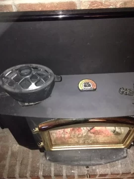

Here is the ledge on my Napoleon 1402. I have boiled water in a teapot no problem. The cast iron pot on it is on a trivit so it just gets warm and slowly evaporates. Be very careful with water around a stove. I wouldn't want to splash the hot glass. [Hearth.com] Wood Insert that Boils Water - Quadrafire 5100i?
