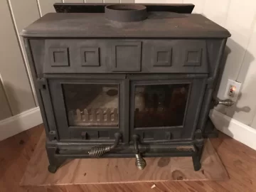

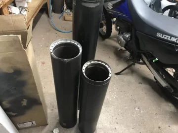

Hi Ladies and Gentlemen,
I’m reaching out for help here, as I can’t find any locally. I live in central Florida which isn’t exactly a thriving market for this sort of thing. This is my first house I’ve had that doesn’t have a fireplace and I figure a wood stove will satisfy my needs. I found one on Craigslist and I liked the look of it so I jumped in. At first I was gonna just install it in my porch room since most the year it wouldn’t get used. But now that the temps are dropping and I’m thinking about my electric bill soaring from our electric heat pump, it’s a no brainer that I want it in the house. I’m gonna install this myself.
Main questions I have:
Do I need to do a building permit etc?
Can I safely just set this on the floor? (Tile on concrete slab)
Is there a good kit that includes all the parts to get from the drywall ceiling out the roof?
I’m trying do do this cheaply so money counts.
I’m including pics of everything I have.
It’s currently sitting in my porch room, but it’s gonna go where the tv pic is(tv is getting moved)
Thanks in advance for any help, Ed

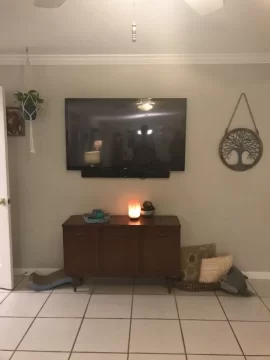

That is a good spot for a wood stove, you can install it right on that tile floor. I don't think you are going to use it too much there in central Florida, but, what the heck?

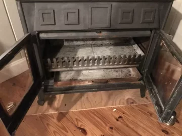

What kind of stove is it, and when was it built?
If it was built before 1993 it is called a "non EPA" stove. These old time stoves are good stoves, and are more forgiving about going through a wall. Because if it goes through the wall, there will be two 90 degree bends in the pipe. These bends slow down the draft. These old stoves will work OK with two 90 degree bends in the pipe.
If it was built after 1993 it is probably an "EPA approved" stove. These newer stoves are more efficient but need a good draft. With the EPA approved stoves, you usually need a pipe run straight up through the ceiling, with no bends in it, in order to get a good draft.
Not sure on the year model. It’s a Dovre 300hsb.
It’s gonna have to go out the roof because it’s in the very center of my house. I’m trying to avoid bends but I might have to use a 45 to get past a truss. I’ll upload some pics here in a bit. Thanks again, this forum is a wonderful resource

Here’s the stove location

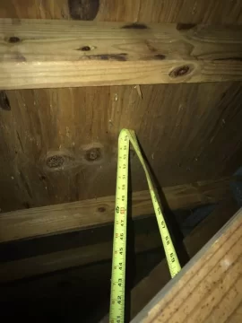

Here’s attic pipe location. If you look at the tape measure spanning the trusses, 62 leaves the stove too far from the wall, 67 would be perfect if that’s possible?(need help here)
The flashlight in the second pick is roughly where the hole will be, 11in from that big duct

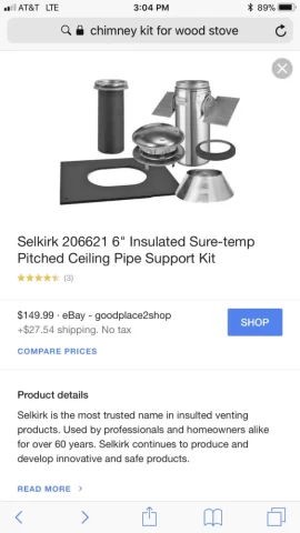

Finding different kits. Not sure all the upsides and downsides to these kits. A little guidance on watching out for possible pitfalls would be nice.
[Hearth.com] Wood Stove amateur installation. Need help

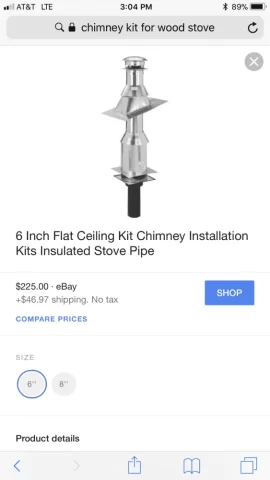

Or this one
You will be in good shape, going through the ceiling, with maybe one 45. Any stove should draw well with that kind of pipe.
So your rafters are 24" on center? if that the case you can frame a box for the ceiling support and get it near 64" What does the stove manual say as far as real wall clearance? BTW, both kits will work great, just make sure if you get a super vent ceiling kit, that you use super vent class a pipe, same with dura products. The black pipe should not matter though

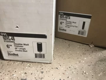

Is that black pipe I have safe to go into the attic or do I need something else for in the attic?
You need class a chimney in the attic to. You can only run black pipe to the ceiling where you will transition to chimney pipe that will fun all the way out.

It was about 55in to the roof decking from the drywall in the attic, so how does getting the exact length you need go?
Thanks

It has to be class a from when it passes through a ceiling or wall untill the chimney ends above the roof.
Does the class a pipe connect to the box on the ceiling, or does it just pass through the box and connect to the black pipe?
That depends on the chimney system you choose. Most sit in the support box with an adapter sticking down through that the pipe is attached to
