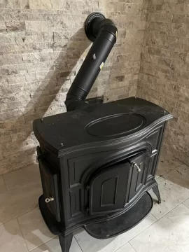

I do have a CO detector down there now. It came with the house so I’m not sure, it says Defiant on the side with a photo attached
It does smoke a little back into my home even after everything is heated

The old Defiant did not have an outside air connection. If you look at the stove's flue path, you will see that the smoke has to make 3 90º turns just to get out into the chimney. That is slowing down the draft quite a bit which is exacerbating the situation.
The paper labels should be removed from the stovepipe.

The old Defiant did not have an outside air connection. If you look at the stove's flue path, you will see that the smoke has to make 3 90º turns just to get out into the chimney. That is slowing down the draft quite a bit which may be exacerbating the situation.
So would you recommend I start with changing the flue path? Given the height of the stove to the flu, is that going to be a problem? Or would you recommend I go with a OAK first?

Casadecorgz is the bypass open when starting the stove? This is a downdraft stove. It needs to get warmed up nicely to draft well before closing the bypass.​
The first thing I would try is moving and rotating the stove to where there are only two 45º turns in the stove pipe entering the chimney. It may need to come forward a bit to accomplish this.

Sorry, which part is the bypass. Is it on the stove or the lever on the flue pipe?
No, that is the stove pipe damper. It is very possible that you don't need one at all. It too will slow down draft a bit, even when wide open. I'd remove it when reconfiguring the stovepipe.
The stove has the bypass damper lever on the left side. I think the bypass is open on the Defiant when that handle is horizontal and closed when it is vertical.
Is there a 1.5" deep layer of sand on the floor of the firebox? This stove must have that before burning in it.
