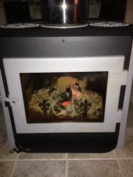

The Ideal Steel can definitely go longer than 12 hours
Here's a pic of mine at 18 hours on a full load of softwood
That said, the longest burns are definitely reported from the BKs.. I'd say if you want an easy 12+ WS or BK, if you want an easy 24+ then BK.

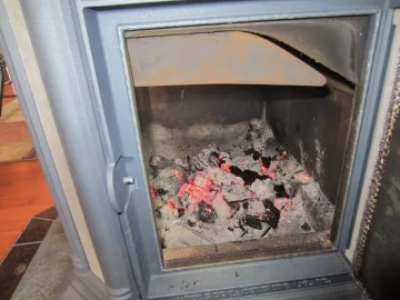

Working on a 16+ hour burn as we speak with the Woodstock PH. This picture was taken at the 15 1/2 hour mark. Overnight low was 28*, great room temp where stove resides is 74* and rest of house is 70*. Stove top temp is 204*. Burning 5 splits of oak and hickory.
