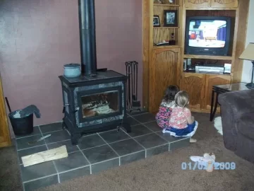

I really like the hearthstone. It works just as advertized including the "heat life" properties that both soapstone brands love to tout. I have shoved just under 10.5 cords through the stove. 7 of those cords were cottonwood and the rest was red alder, western red cedar, and douglas fir. This stove runs great on cottonwood with easy overnight burns. By that I mean I can load 4 large chunks, well at least as large as 4 can be in a 2.3 CF stove, of cottonwood into a 400 degree stove at 10PM and restart from the coals at 7AM. I do this EVERY night and have never been skunked yet. Hey, I admit that at 7AM the stove is down to 200 degrees but within 15 minutes of reload the thing is back past 400 and heating us up. On the other softwoods the burns don't seem much longer but they do seem be hotter. My next 9 cords of wood is doug fir cut to 18" long for the 21" long firebox of the heritage.

Here's a photo just because we all like photos.

I really like the look of that hearthstone.

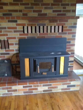

It's really between that and a Blazeking. I'm gonna have to do some SERIOUS hearth remodel for which ever stove I chose. I don't care for the insert. I just don't really like it.
Here are a few pictures of my hearth.
I think if i go with the hearthstone, I'm gonna go for the "big boy" EQ. Cottonwood? I know where I can get a TON of that for free. It just stinks so bad when burnt..
My chimney is already is clay flue liked 8x8, with an SS liner to the first flue tile and a block off plate. *According to the original owner, yes, i'm gonna check on my own!*
