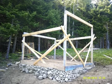

The pile of rocks came from my driveway. I graded it again with the scarifiers set fairly low and tried to get every stone larger than my palm out. The stones were stacked under the posts and the perimeter of the mini barn. I have a few more piles to back fill with, but I'm going to top it off with some 3/4 crushed stone up to the tops of the wooden frame boards. The gravel will be topped with wood chips and should allow for drainage and ease of mucking. I'm hoping to get the roof up next weekend, or at least underway. So far I've been able to use leftover materials from other projects. The siding will be stained board and batten so I can practice before doing the house. For the roof I'm thinking B&B or metal, depends on which pencils out cheaper.

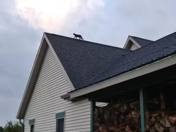

Getting some of the wood inside, near the back door, now that the mid summer drought has dried the outside stacks up a bit. I use 1-1/2 conduit in the garage to straighten up the ends and make stacking easy. Run it up through the ceiling, then down into an anchored 2x4 with drilled holes. Fence wire between to pull in the ends. Woodchucks found their way in again to the outside stacks. They make cool grass nests, but they really need to find somewhere else to do that. The cat wasn't content watching wood get stacked, so found other ways to stay occupied.

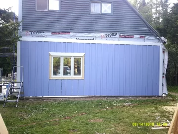

Yesterday we mostly finished installing the siding on the first floor east wall. Unfortunately I cut the left and right window trim too short so we were not able to finish everything yesterday. Due to time and costs the second floor on the east side will wait until next summer when we can bury the power lines and move the electric meter to the pole. The first floor south wall has strapping and is mostly prepped for siding and trim. Progress slowed when the scaffolding had to come out. We are hoping to get all of the exterior done before winter, with the exception of the second floor east side exterior wall.
We bought planed 1x12 boards and made them into our siding ourselves. The second floor will be done in natural cedar shingles with the same white trim on the corners and on top. It's not perfect, but I think it turned out pretty damn good.

Looks great! Did you end up doing any z flashing above the window trim? I have board and batten siding on my house as well and I need to replace window trim on a couple windows.
The window has several layers of flashing beneath the trim and siding. I'm using the white trim pieces also as battens. I do plan on using a piece of z flashing above the trim all the way around the house. It's probably not necessary, especially since I plan on flaring the shingles out at the white horizontal trim, but my wife wants it. Perhaps in time we will change our minds about the window trim/flashing as well.
