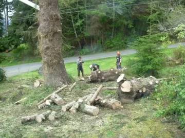

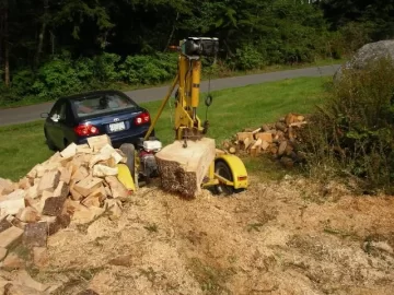

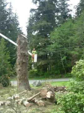

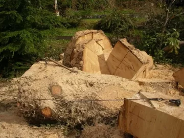

For me its was this spruce tree in my mother- in- laws front yard . Three days of noodling,machine splitting,and some swearing spike in the middle of the trunk .
