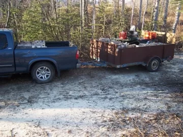

I have a 3500# single axle. Hold about 1/2 cord green birch & the ATV.
Some in the truck.
3/4 +/- cord per trip, better than the 1/3 cord if & was just using the truck.
[Hearth.com] Would this trailer work for a wood hauler?
I did upgrade to a dual axle , 7,000#, over winter, full cord & the ATV on the trailer now.
Just gonna be a longer day to get it filled. LOL :)
Yet to see how it works out.
