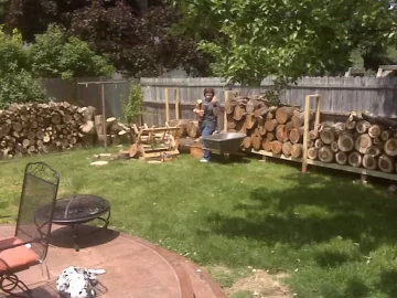

I'm looking for a presentable method to cover our wood piles. Since they are in our backyard in a suburban area, I have been banned from using the blue tarps, sheet metal roofing, etc. Since the consensus is that you only need cover the top, then I was wondering if this would be a good option: http://www.lowes.com/lowes/lkn?action=productDetail&productId=10290-278-LB01&lpage=none
The stacks are lined up along our fence line so they are only 2' deep at the most and long, in 8' lengths (see pic below). Those were taken last spring and are now full almost all the way to the top of the fence. I was thinking that the 3' width would be perfect as it may drape over the front edge to direct snow away and it would be easy to get to the wood this winter. Our other alternative is Harbor Freight tarps which we would have to cut to width and then come up with a method to hold them down. I really don't want to just throw logs on top to hold it down, but will if it comes down to it.

it looks like you have some uprights along the one side what about cutting some plywood angled so the water will run off and making them into some bin like units.

The Picture of your wife giving you "the finger" is priceless!

I think you're taking the ban on metal roofing too seriously. You have really nice looking shed like racks. Bring the back up another 2 feet or so and make a triangle with the 2X4's then run 1X4 as stringers for the metal roofing to screw to. Have your wife go with you to a metal roofing manufacturer and pick out what color she wants. Go home and slave cutting the stuff in 2' lengths... then install a little perm. roof. It will look great. Ace has brown tarps if you're looking for something a little more earthy. But my first thoughts were still finishing the great looking racks you've built.
edited to say... metal roofing if it's just a wife ban and not some city thing.

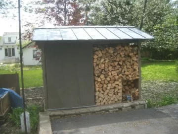

Metal roofing looks great. Here's a pix of my wood shet. Lead (terne) coated stainless steel.

Yea, I saw that thread. That was a really nice wood storage. I am thinking of doing something similar to these units next season when there is a little more time. As for the amount, there are two cords along the side where the pic was taken, another 4 face cords along another fence line and probably another cord in piles stacked in various places. For this season it gives me 3 cords which we hope will be just enough as this is the first full season. The rest of the stuff we have is for 2010/11 as I will not burn it if it's not seasoned. Even some of that is oak which I will make sure to push it into the 2011/12 season just to make sure. As for the bright blue tarps, we put them down as weed barrier in another part of the yard covered by mulch! Every now and then you see some of it peek through!

Is it just me, or is she flipping the bird in that picture?
