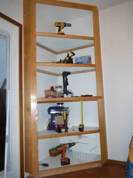

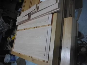

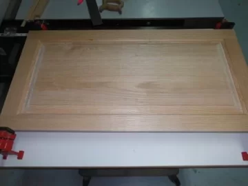

Wife wanted a shelf
Started making a corner shelf for birthday present. Then decided to add cabinet doors.
Not done by her birthday but by Christmas.

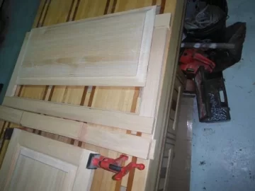

Got doors to the glue stage today.
[Hearth.com] WV red oak [Hearth.com] WV red oak

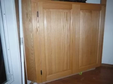

Took a while to get the doors urethaned.
4 coats & still the red oak was creating bubble in the finish.

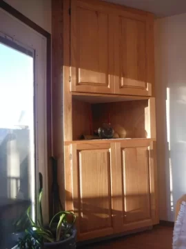

Hung the cabinet doors today.
Nice Dave. Looks like melamine shelves?
I've got several hundred bd. ft. of oak in the shop waiting for me to make something of it.

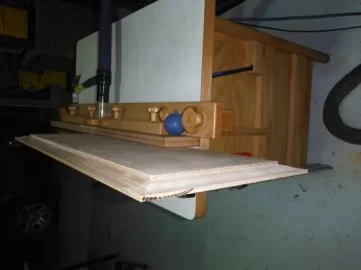

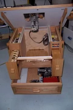

You made the router table too, I'll bet.
Which brand router bit set are you using?
Of course, you'll post pics of that in it's completed state.....right?==c
ETA: N/M
Nice Dave. Looks like melamine shelves? Painted 3/4 " AC plywood
I've got several hundred bd. ft. of oak in the shop waiting for me to make something of it. Winter a good time to make something.
You made the router table too, I'll bet. Yes, a fun project & a good wood shop tool, lot of uses
Which brand router bit set are you using? "White side" cabinet door bit set.
ETA: N/M
Should've used a wood sealer first, fast drying.
2 coats usually works for red oak but didn't have any.

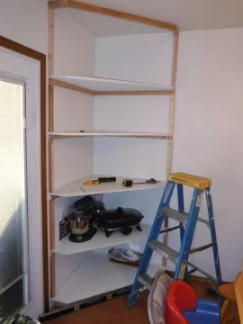

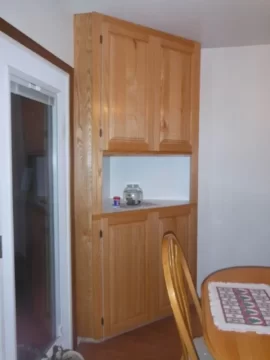

Some floor trim & a few touch ups. Almost done ;)
Wife wants center section an open shelf.
Fantastic work, Dave. And PDave already asked my question about the shelve parts. I actually want to build a corner pretty close to what you have except the center opening will need to be larger to accommodate a flat screen.
What is the total width of the face - and did you go by plans or just "wing it"?

Built custom for the corner. front width is 35-5/8"
Built the bottom base out of 2X4s, then a 1-1/2" X1-1/2" (2 X 2s ) frame , 3/4" plywood shelves, then covered & faced with red oak
& made cabinet doors.
Used 3/4" oak face ply wood for the 6" wide sides.

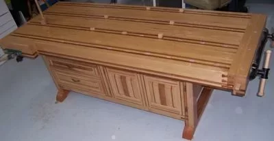

My Dad had a saw mill on Granddads farm in WV.
We cut some red & white oak, maple, cherry. Cut into boards.
Planed a few years later & I shipped them to Alaska.
The Wood has a family history ;)
Made a maple & cherry work bench, router table, some other stuuf from some of it.

That workbench and router stand is WAY too pretty to use in the shop!!!
Move it to the parlor.==c
