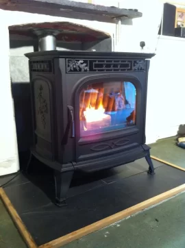

    these guys have given you the same advice I would. If you could post up some photos of your install and the brand of pellets you use. I am curious to see the size and shape. My XXV is a 2011 and is extremely quiet, I feel it is the best FS Stove in the US.:cool:

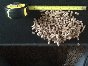

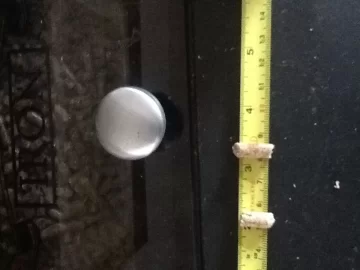

    Our XXV and our pellets. These are to a european standard, not sure how that compares to US pellets. I would be interested in your thoughts. Not the most flattering angle for the stove...

    Sorry about that, caught some of us while enjoying libation time. Pellets look to be loosley bound, (or not as tight) do you get much dust in the pellet bags? Follow link it will get you started

    Not sure what the slide plate is, but I like your setup. You're going to love that stove!
