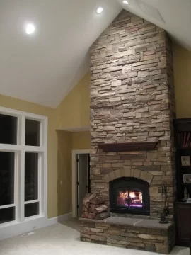

I love the stone work on your chase!!!! Did you build your hearth with the same look?
Thanks, Got Wood........I did the stone masonry, it's one of my new hobbies. I'm still in the process of the hearth, but yes it is going to be the same stone, and the same look. I'll post pics of it when I get to it, probably sometime here in March when I start the stonework.

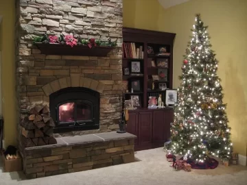

I would love to see it when done. I did the stone work on our hearth (pic on first page of this thread). I loved the project. Lucky I have a good friend who was experienced and guided me along the way. Personally, I think the stone look on a fireplace looks the best.

you did a fantastic job on your hearth as well, I noticed it a while back and it is one of my favorite on this forum. There is something about stonework that is warm and cozy, it seems to make you feel relaxed and comfortable, esp. in the colder months. I did stonework in our kitchen and our outside foundation, made the house look amazing....

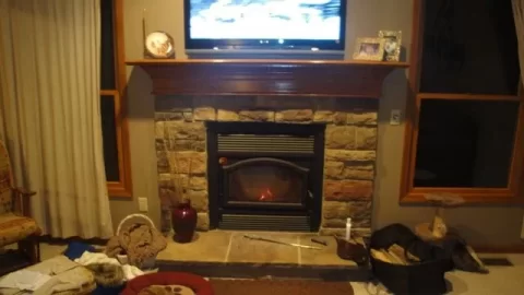

I do have one more question. I see in the pictures posted here that some people put theior flat screens above the ZC fireplace. I asked the guy at the store about this, becuase that is absolutely my plan als, but he said not to do it at all. He said there is way too much heat in that spot for a TV. Both from the ir being blown out the front and the chase/wall behind the TV gets vry hot also.
Anyone ever have any issue with this or even a solution? Thanks
Great. Keep on looking. It's not the ideal location for a TV, but folks still do it. A stone mantel will help block some of the heat and the TV bracket will create about a 1" air space behind the set. I would think you could also insulate the interior wall of the chase behind the set. And try to get a fireplace that uses class A pipe which will be better insulated.
My tv is above the fireplace and the way the installer put the mantel in the TV stays cool.

KTM, I'll add my 2 cents. I have the Quad 7100FP ZC fireplace and it is the primary source of heat for our 2964sqft 1-story house. It does a really nice job of heating the house; we are pleased with its performance and aesthetics. That said I would also agree w/Milt if we lived in a different climate. In OR where I live the winters are not that harsh, and aside from the 2-3wks during the winter where it is in the 20s during the day and teens at night, most of our 4-5 heating months are one big shoulder season. If we lived in a really cold climate, I would have installed a free-standing woodstove.
My stove is in a chase w/stone veneer (see pic) and the flue is 8" SL300 air cooled pipe which is specified for this particular unit. I plumbed the aux air to pull air from the far end of the house. Can't verify how effective that is, but when I designed the house I placed returns in the ceiling above the stove in the great room as well as the vaulted ceiling in the kitchen so I can simply turn on my HVAC fan to recirc the air. I've measured the ceiling temps w/my IR gun up to 109deg and the air coming from the floor vents at ~86deg so I know warm air is being effectively circulated by the HVAC fan. I also typically have the blowers running full on the unit, with the Rheo set to cut off when the fire goes down. I have been able to get 6-7 hr burns w/enough coals to get a fire going again.
