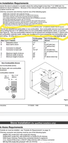

The stove we're considering (lopi evergreen) says specifically that it has to be 3.5" of masonry, spaced 1" off of combustibles.
That spec in your last sentence is right out of the fire code for the back wall. I’ve never seen it required for the ceiling. It doesn’t pass the sniff test.

Thank you for that. You read it right and I can see why it was written that way to address putting that stove in an old fireplace. I looked up alcove in the dictionary and it is:
"An alcove is a small area of a room that is formed by one part of a wall being built further back than the rest of the wall."
So you don't want a typical alcove, you want to build something that looks like a masonry fireplace and put the stove inside. Why don't you put the mantle at 5' but have the actual ceiling of the combustible alcove up at 84" or at full ceiling height?
I would skip the mantle and go 84" if I was you.
